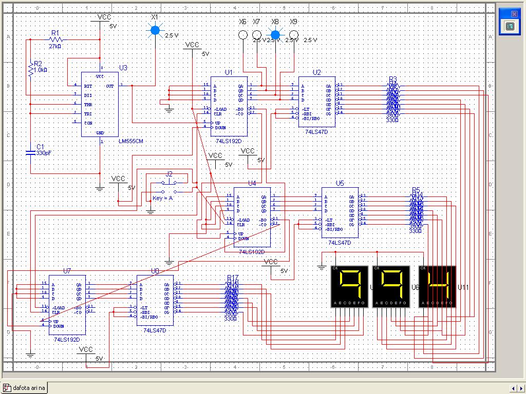

3 digit up down counter
here's the circuit.
frenchneco said:
yes! we finally figured it out. we were just so stupid to see it. the voltage in the display is just high. the preset voltage drop in the multisim program is 1.66V.
we also got the other digits figured out, which came easy since you helped me. we were just laughing at ourselves after, since it was not hard at all. but the only problem is the starting count is not "000". it would either display "999" or "001". we're thinking of connecting it first in the reset? any suggestions?
Looked at your circuit, as you switch ON, the 555 is probably putting one count into the 1st LS193. Do a manual RESETafter power up or add a Resistor/Capacitor RESET to clear the counters on power up.

PLS HELP ME TO CREATE A CIRCUIT 2MINUTES UP COUNTER UNSING (3) 7segment display, 74LS192, 74LS247 and LM555.
