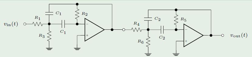

here is 1 of solutions for 1 channel but i am not sure what and how should i regulate gain of +-12
and i have to do it for all 3 bands

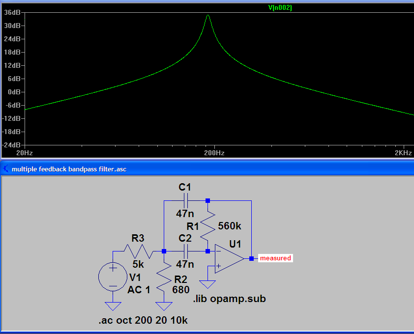

You show two Multiple Feedback Bandpass Filters in series. Why two of them??
This filter has a narrow frequencies peak then the slopes away from the peak are very gradual at only 6dB per octave which is not what you want.

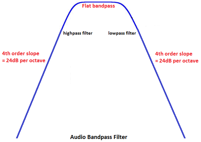

Your teacher probably wants the bandpass filters to be made with a 4th order Butterworth highpass filter then a 4th order Butterworth lowpass filter that will produce a flat bandpass without peaking.
