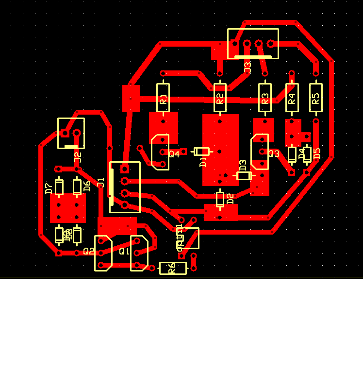

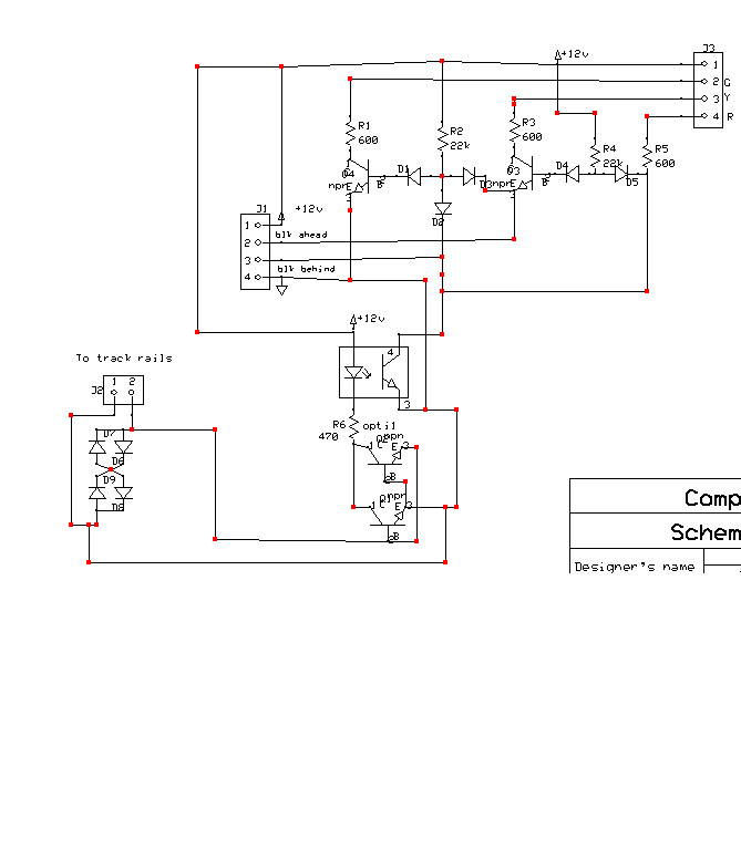

schematic and pc board
Here is schematic for one detector and signaling circuit combined.
Pretty sure its right but double check.

Hello Angie,
I suggest you use the one I sent you. The PC board and the component layout is all there. I sent you an updated version with component values inserted. Forget about signal transistors and diodes for now. We will address that later after you decide how many units you want to build. Then when we do a cost/performance analysis. The TIP31C transistor unit is more sensitive than the signal transistor with shunting diodes version. I suggest you build the TIP31C version first. Then you will have enough confidence to try the signal transistor version. Now your decision can based on performance versus cost. The difference is pennies anyway.
Pete

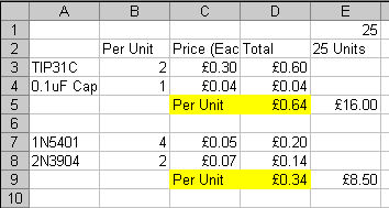

I just got a comparison quote for 25 units. I know there will be at least 25 if not more units required. The more I build, the cheaper they become due to bulk order of components.
I think I'll be going with the one I already got working as the twin-t is twice the price due to the cost of the TIP31C's

This works perfectly. With 1 dry finger on track!!!!
https://www.electro-tech-online.com/attachments/working-jpg.36249/
Cool, but now take out two power diodes and try it. It should also work and it will be more confortable for the two signal transistors.

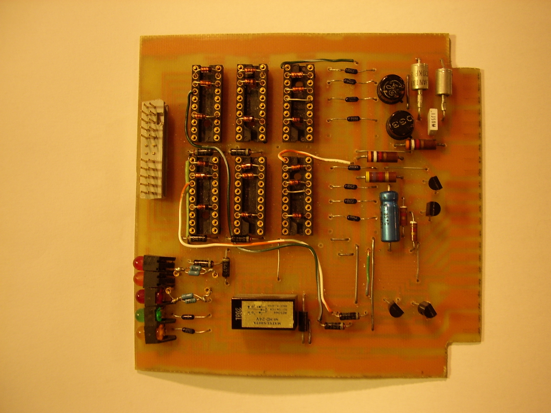

Attachments.

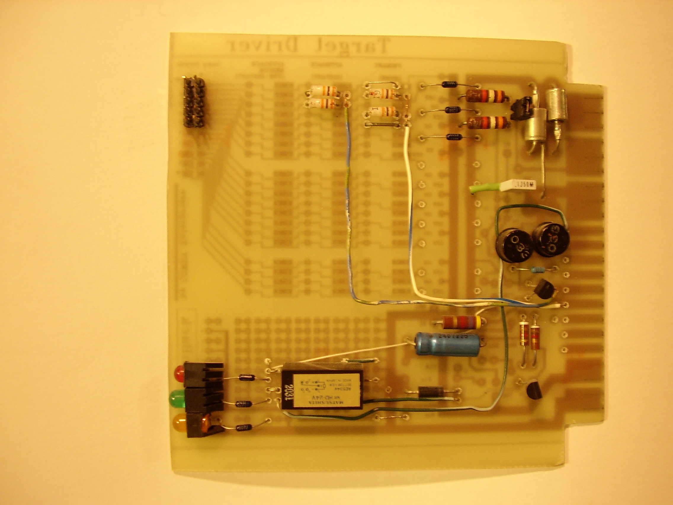

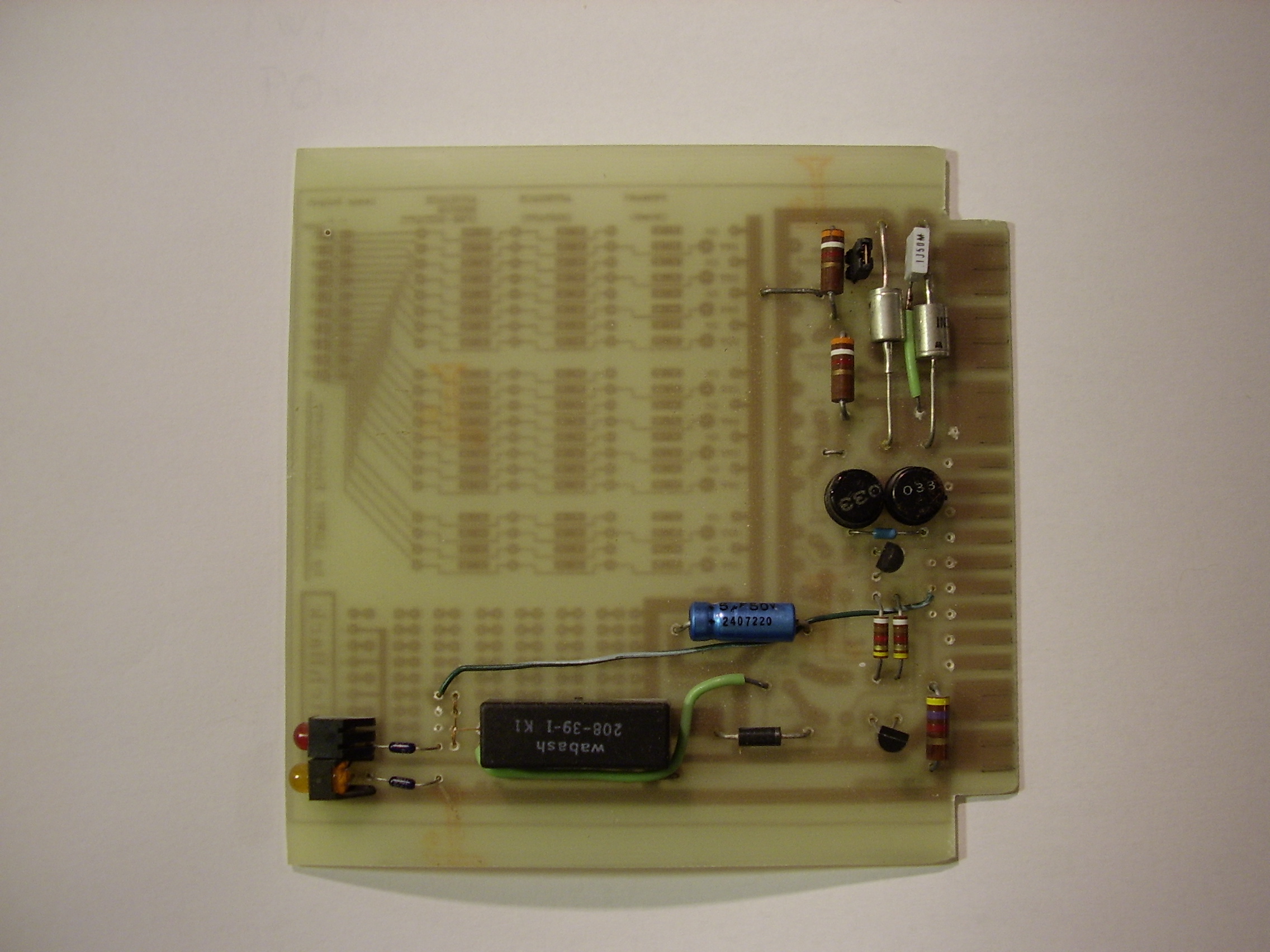

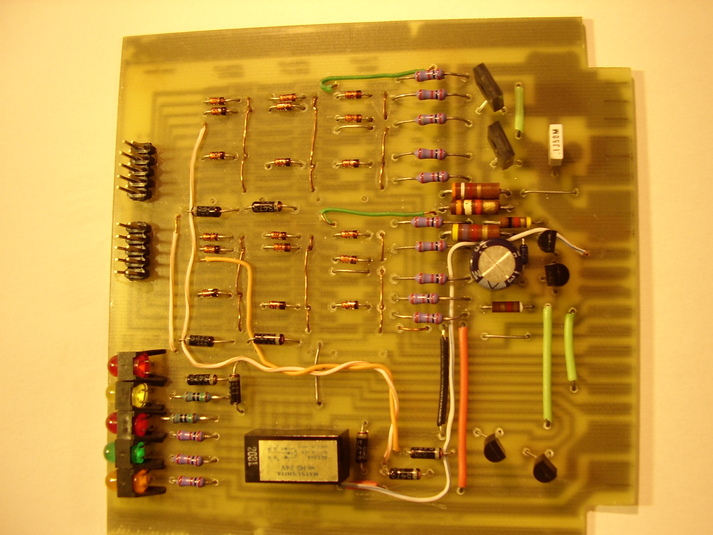

I took pictures of the Pc card I am using. Notice that I used two signal diodes with TWO power diodes across the PN junctions. There is one however where I used two power transistors without any shunting power diodes. The 'detector only' card is now obsolete but it still indicates the Twin-T, a booster inverter and a debouncing relay driver. The delay is about half a second.
The simple-ABS signal has the diode matrix populated with the LED current limiting resistors and the four diodes used to contro them.
The development board is a prototype wherby I can move the diodes around to change the aspects. It control two 4 aspect signals and includes a flash unit that indicates a 'diversion clear' which has two yellows with the upper one flashing.
The dbl sig 5 aspect one is a finished 'production' card. It controls the entry to a station and drives 5 aspects. It drives four normal aspects and a warning flashing white for 'shunting in progress' . This allows a train driver to take his engine 50 meters past the flashing white for shunting purposes.
Note. This last card uses power transistors without any diodes. It is very sensitive but the reason I used them is that I'm running out of signal transistors and I had power transistors in stock. I was told by an expert that the Twin-T won't work with DCC. Hm! I guess he was an "ex spurt". Bill's
OK but take out two power diodes. I don't have any experience with the Twin-T using 2N3904s. That drops the price by another 10p.
Seems like a lot of components compared to my 8, 4 diodes, 2 transistors, 1 resistor and 1 optocoupler.
Now I need to work out the connection of the optocoupler instead of the led and then the pcb for a detector only circuit with 2 connections one side (dcc power) and 3 the other (12V, Gnd, Detect)
