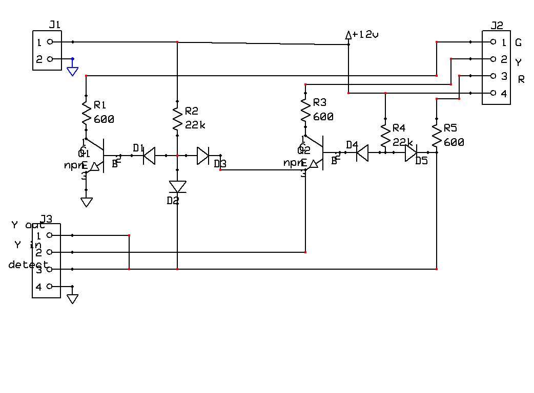

Hi all,
I've followed the circuit here **broken link removed** and came up with this layout on my breadboard **broken link removed**
Tested three blocks in a loop with green in going to ground to enable green as default on all blocks. All worked.
Built single block on stripboard and tested as single block.
Green light is on by default, so far so good.
When yellow out is put to ground red led comes on but green just goes dim. Likewise when yellow in is put to ground yellow led lights and green goes dim.
On both occasions green should go out.
Any ideas why the stripboard fails were the breadboard works? I've checked for shorts across the tracks and track breaks are fully broken. I have already built this circuit once and it did the same, and after removing all the components they were still all working correctly.
Starting to pull my hair out atm so any ideas would be helpful at this time.
Further to this, if I touch Q1 the green led get's brighter. As I have no idea about components, only how to follow a schematic, is this usual, i.e. is my finger acting as an antenae for the transistor and getting a signal from the D1 diode?
In which case, is the transistor too close to the diode?
read further down about adding more diodes.

Appreciate your time on this MrDeb. I read the notes about additional diodes but it says that's when it's being switched by a block detector which is the next item on my build agenda once I have this signal changing system sorted.
At present I'm just using a switch which, on the two blocks on the breadboard work perfectly. This is why I'm confused. If it works on the breadboard why doesn't it work on the stripboard.

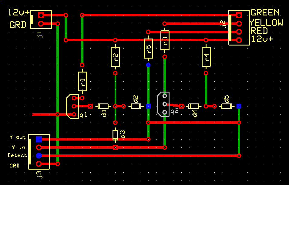

This is the layout and the resulting circuit shown below in the photo. I have tracked and re-tracked routes through the circuit and it looks ok to me, any chance you can give it a once over. If it's correct then it must be the soldering I'm not so good at

I think your missing grounds
here is a strip board layout that might help.
I used basically same layout but added additional connectors.
see schematic.
green are jumper wires and red are the strip board traces
hopfully this solves the problem?

WELL did you get this circuit working??
lots of posters help but very little feed back on results.
As you said, 'checkyour circuit board'
I have no idea what readings I should get, and where I should get them, but I did check all components and all were working. I re-soldered each joint to the transistor that was causing the led to glow brighter when touched and that has made the green now go out when yellow or red are lit.
Another issue has materialised now. It may have been there before but due to the more immediate problem I never noticed it. Now, if block 2 is red then this block goes yellow, not a problem. However if this block then goes red at the same time, the yellow should go out and the red come on but this is not happening, the yellow and red now share power when this situation occurs.
I've ensured there's no shorts across tracks and the problem still occurs. LEDs are now fixed brightness. Could this be Q2 as the problem, is this the behaviour of a blown transistor even though it does appear ok?
did you use a heat sink when soldering transistors?
if not then you very well may have cooked a transistor.

I built circuit in simulation program TINA (free down load)
It works fine.
It sounds lke your circuit is working right (see schematic of 5 blocks in link you posted)
should be 0, yellow, red, red, green
if you download TINA I can email you file then just probe with DVM
real easy and very graphic.

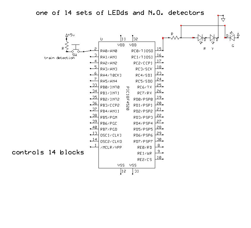

Have a PIC designed circuit
no transistors, a lot fewer parts and only two wires from controller to each set of LEDs
using cat5 cable you only need one cable to each block.
CAT5 is cheap and could use RJ 45 plugs to make wiring easier.
circuit description
train in blk F
ALL GREEN LEDs on except BLK F
RED LED on BLK F and YELLOW LED on BLK G
one 18F452 can control 14 blocks
very easy program, I or some one else on this form can program. Just pay for shipping and PIC. If you want, get 2 pics free from microchip as samples.
Pic is under $5
PCBoard, I can etch as well. just pay for shipping.
soldering= are you using small diameter rosin core solder?
I found lightly sanding board before soldering with 400 wet dry sandpaper. Dry using paper towel, Alcohol helps as well.
Also procure a tub of rosin soldering flux. Dip tip of solder into flux then apply heat to board then apply solder. YouTube has several soldering videos.
I use a Weller pencil tip iron 25W, .022 solder and flux. All available from Radio Shack.
What are you using for train sensors?
Using a PIC will cut down on wire and headaches.
some what dependent on your train sensors, the same basic circuit can be built w/o the pic. just using one transistor per block.
I don't understand how the PIC drives the three LEDs on one output. It looks like it requires Vdd to be less than the sum of forward voltages of the LEDs. If Vdd is wrong or the LEDs come in at the low end of their range, some LEDs could blow up, but at a minimum there would be ghosting.
[edit]Since the PIC inputs are either high impedance or weak pullup, the switch on the input is wired wrong. The input should be connected to the junction of the switch and resistor, and one end of the switch should be attached to Vss (or Vdd), the other end of the resistor to the opposite rail.[\edit]
The inputs read either high or low
the outputs go high or low depending on the input.
didn't include any resistors in the output but yes they need resistors.
two LedS IN SERIES THAT ARE CONNECTED between OUTPUT AND GROUND(dang caps lock)
the green LEDs are connected between output and Vdd
when output goes low the green leds light up(all the outputs are low untll train sensor inputs change states )then the corosponding output goes high, green goes out and red & yellow come on.
