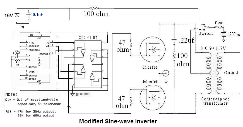

A pure sine inverter will be much harder to make than a modified sinewave.
You need a motor controller h-bridge IC.
It's possible to generate the modified sine shape using a couple of logic ICs.
https://www.aaroncake.net/forum/uploaded/Audioguru/200885121135_modified Sine-wave Inverter.PNG
A pure sine inverter needs PWM.
You shouldn't need a transformer, if the output doesn't need to be isolated from the input.
https://www.electro-tech-online.com/custompdfs/2010/04/LMD18200.pdf
As I said before, a boost converter is needed to get a higher voltage than 34V, to make up for the losses in the switching transistors, 35V or 36V will probably do.

What are the 2 specific Mosfets used in that circuit? All other component values are described in detail.
Also, excuse my ignorance, I don't recognize the schematic symbol located between the two Mosfets. One terminal connects to both mosfets, arrow coming out of the center of the circle pointing down is to ground.....what is the actual "small circle"?
The MOSFETs are part of the IC.
You need an LC filter on the output of the bridge to filter out the harmonics leaving a pure sine wave.
What you are building is a class D amplifier. High quality class D amplifiers are uses for audio but yours doesn't have to be so good. Lots of information on class D amplifiers can be found on Google, Wikipedia etc.
I see, the Mosfets are the LMD18200 IC.....different than the ones used on the schematic, though, based on the pins available.

By the way, I don't know what was meant just above that "the Mosfet's are part of the IC" IC's are IC's and Mosfets are fancy, very effecient amplifiers like transistors.
I found what those mosfets are in the schematic, they are IRFZ44 available at mouser.com for around 2 bucks each.....in case anyone has been monitoring this thread and wants to give
a shot at that inverter circuit.
