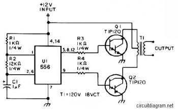

I found the attached schematic to make a simple square wave inverter. Based on the transistors it will provide 1 Amp at 24VAC
How do I calculate the step-up transformer I need.
1)Coil ratio
2)Watts (heat dissipation) VA rating? (how thick the coil windings need to be)
Size is important because I am using a project box of a specific size, with a self contained battery to be handheld unit.
The size of the step-up transformer I believe is what will be my biggest enemy for what I want to accomplish.

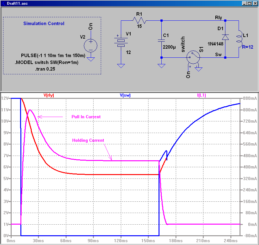

Here is how to get a higher pull-in current, followed by a much smaller (1/4 the power) holding current to your relay coil, starting from 12V.

I like the posted circuit, safety diode, cap to take the inrush of current and 5 ohm res to limit the current.
I don't have a 5R resistor but I am afraid that if with 10R my relay didn't even click...5R will not work very well either!

I am trying to figure out the transformer needed. Need center tapped 12-0-12VAC in/24VAC out.
I believe the ratio is 1/2 but what is the VA or Amp rating (thickness of the wires) Need trans at 24VAC at 24Watts.
Does anyone know the caculation.....and/or what transformer?
It's not likely that the relay will like square waves any better than it liked DC. Half of the energy of a square wave is in the odd harmonics, and an AC relay is only expecting the frequency for which it was designed.
The transformer ratio has to take losses into account, such as the TIP120's which will take about 1.2V. The transformer will have its own losses which also must be paid up front.
If you really must try an inverter, look into "modified sine wave" (really modified square wave).. it uses simple logic to reduce the harmonics dramatically.
A better option is to use a switch mode power supply to boost 12V to 34V (the peak voltage of a 24V sine wave) and use an h-bridge to convert it to a modified sine wave.
That way, you only need a transformer, if the AC needs to be isolated from the DC supply, which in this case it doesn't.
