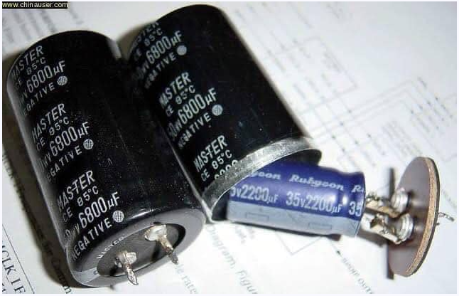

Pommie, you asked Gary last year if his fake capacitors were Chinese. His photo came from China User.com. Are you a xenophobic racist?

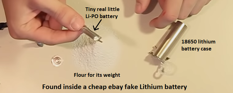

There are videos on You Tube of disassembly of cheap ebay batteries from You Know Where.
Here is one video:
In the video they show the fake battery is mostly full of flour and here is a clip from the video:

Gary the thread starter says he cut open cheap batteries that have styrofoam balls inside and I showed photos and a video of cheap Chinese 18650 lithium batteries and electrolytic capacitors that are fakes with flour inside. There are many more videos about Cheap Chinese fake things on You Tube.
