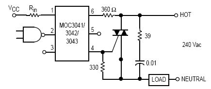

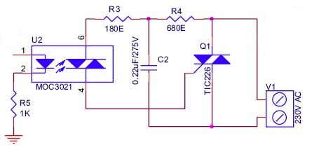

I want to switch a 230V AC supply for bulbs using a 5 volt signal. I do not want to use relays, just triacs.
The problem is i dont know if the load is always going to be bulbs (resistive) or Energy Savers (inductors). For this reason i want to confirm that will the following circuit work for both?
Energy savers use electronic ballasts these days.
Use an opto-isolator with a zero crossing unit such as the MOC3041 and there won't be any problems. If you're worried you can connect a snubber network across the TRIAC but I don't see any need for it.

Look out for the circuit you brought. There really is not a great scheme above where a triac whose named like TIC 226 will supposed to carry out a dead short circuit.
LOL yes when the triac is turned on there will be a loud noise and a bit of smoke and your triac won't be there anymore.
If the connector is treated like the contacts of a SPST switch, rather than L & N, then that won't blow up.
Yes Hero999, the basic idea is to attach it with microcontroller. I can use MOC3041, no problem.
Here is a circuit i took out from the datasheet you recommended. What is a snubber circuit?
I have a TRIAC BT137 (600E), i hope it wont give me any problems. What should be the voltage rating of the capacitor and resistor wattages (.25, .5, 1).

It looked like you were going to just connect the TRIAC across the mains in the first schematic but I knew what you meant.
I also notice that both schematics both have a snubber network so even if the load is inductive, it won't be a big problem.

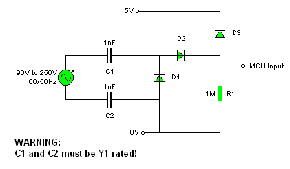

Is it possible to control the phase of an AC fan using the same circuit as well ? For example i use MOC3020 and use a controller to check for zero crossing and then firing the triac to control speed of AC Fan?
Why didn't you say you wanted to do phase control before?
The MOC3041 contains a zero crossing unit so is not suited to phase control because it only turns on when the mains voltage is near 0V.
Use the MOC3021 or ferrite bead for phase control.
Zero crossing checking can be done by monitoring the AC voltage before the rectifier.
No.
The TRIAC is supposed to be connected in series with a load such as a lamp and will never switch a dead short.
The original schematic may have appeared that way but it's obvious the plan is to connect it in series with the load.
The above circuit (without the snubber) is working fine with simple bulb and energy saver both. Now my main concern is the heat the triac will generate. So far for 40W load, the triac stays at room temp. Should i put a heat sink just to be sure nothing will burn up.

please help me with moc3021
**broken link removed**hello haxan this is me santosh gairhe...
now i'm doing final year project in electrical engineering.
I need to switch on and off loads using thyristor/Triacs so i need opto isolator moc3021 for this purpose. I hab bought moc3o21 from the market and connected the same circuit as shown in the data sheet but i faced one problem. When i switch on moc3021 with vcc 5v and Rin 330 ohm the Triac output drive becomes conducting but now even if i cut off the vcc supply the output is still conducting ( output is latched). I dont know how to switch off the output.

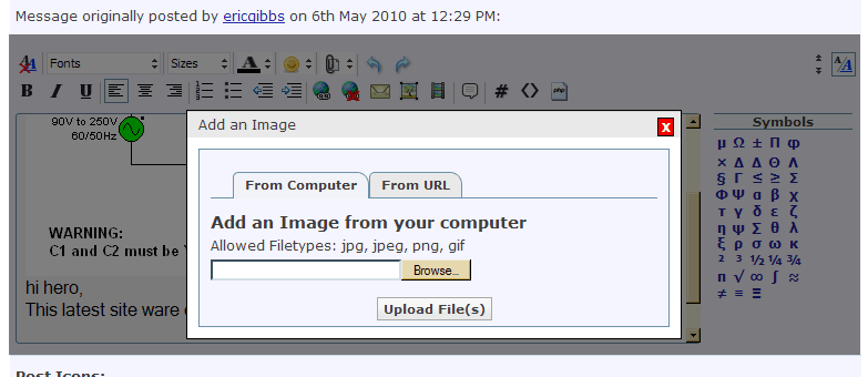

>>gairhe
You can't use image tags with files on your computer, unless you have it set up as a server.
You need to attach the file to the post.
And please use PNG, not JPG for images.
Mains MCU input..PNG**broken link removed**
hi hero,
This latest site ware does provide for IMAGE tags from your PC or a URL.
