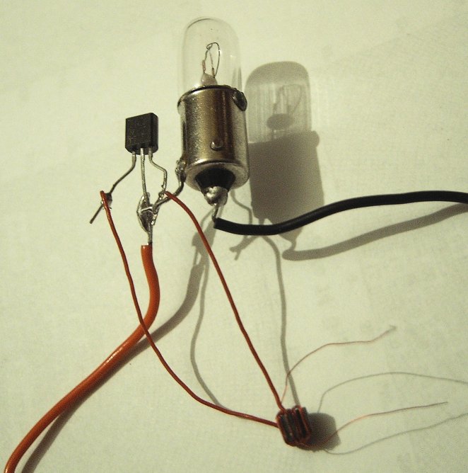

Most of use have heard of the Joul thief but did you know that ferrite beads make handy core for pulse transformers?
Take a ferrite bead.
Wind 10 turns of 0.125mm of enamelled wire for the primary.
Wind 3 turns of megathin PVC insulated hook-up wire for the secondary.
Don't use enamelled wire for both of the windings because the insulation won't be good enough for mains isolation. Most PVC wire can stand 2kV for short periods of time and enamelled wire can't.
I've tried using one turn for the primary and one for the secondary but it took 532mA on the secondary to trigger the triac. With 10 on the primary and 3 on the secondary it would trigger at 10mA.
This simple technique removes the need to buy big and bulky overpriced pulse transformers or opto-triacs.

Regarding the ferrite bead - please describe it in a bit more detail. I do have ferrite beads - I recall that they are available in different sizes and mixes - likely to affect the performance.
I'll post a picture when I find my digital camera.
The ferrite bead has a diameter of about 4mm and a length of about 5mm.
The PVC insulated hook up wire was about 0.5mm thick, including the insulation.
Some ferrite beads are intentionally lossy, and are generally used for EMI suppression. I wouldn't think these would work as a pulse transformer, and I don't think they look significantly different from beads meant to be used as inductors and transformers. Ferrite beads come in a huge variety of permeabilities, effective frequency ranges, etc. Can you give us a part number, or at least a material type?
Otherwise, I guess a guy could just take an unidentified bead, wind a transformer, and see if it works.

You have a good point but I thought they were only lossy at HF. The Joule Thief uses a standard ferrite bead which works excellently and a simple pulse transformer doesn't need to have brilliant magnetic properties just to couple enough energy to trigger a triac.
I tried a couple of ferrite beads, one of them was WURTH ELEKTRONIK 742 700 11 and I don't have a part number for the other. Both worked well enough and imagine that it isn't very critical for a simple pulse transformer.
Here's a picture as promised.
The TRIAC used was a TICP206.
