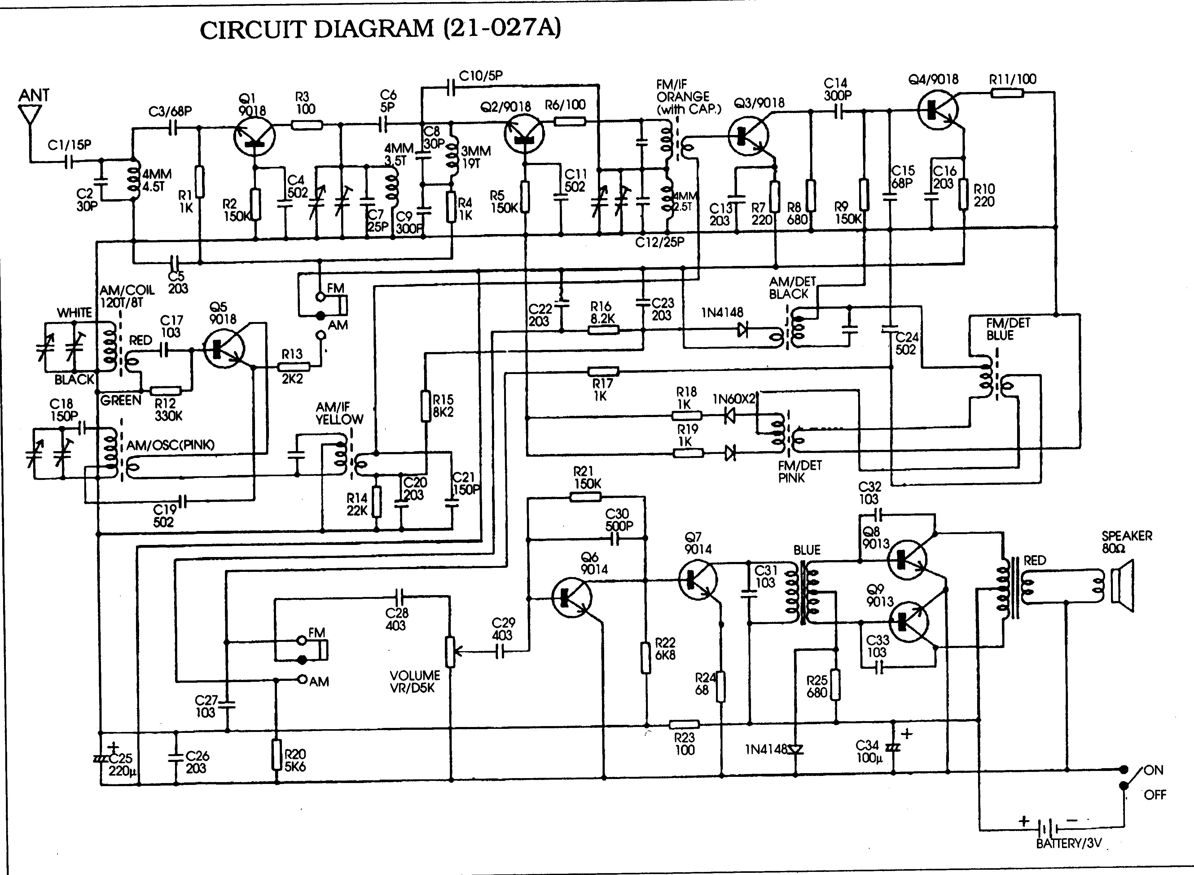

I am fairly new to radio but have been doing other kits for some time now. I decided to get the above radio kit, in order to give me an idea above crystal sets. However I have become stuck after putting it all together.
I cannot find where to inject RF in IF stage. The document is rather vague on this point. I have included the circuit diag and tuning details as supplied.
Also, I am assuming the WOO WOO sound, as mentioned in the document, is dependent on the modulation of my RF generator. In which case I should expect a similar sound to the AF from said generator. Is this assumption correct?

Inject a modulated carrier at IF frequency into the junction of C6 and C8 in order to tune the IF stage (to tune "FM/IF ORANGE" transformer, if it is a variable, and the two variable capacitors beside C12). You inject at the input side of the amplifier made up of Q2 so that your RF generator doesn't load and detune the IF circuit you are tuning. Injecting at the input isolates the generator from the tunable elements. It is important to put a DC blocking capacitor in series with your generator output lead to make sure that you don't create a DC path from your circuit back to the generator. Such a DC path would upset the circuit you are injecting into. We like to choose a DC blocking capacitor that offers a relatively high impedance at the carrier frequency so as to further help isolate the generator from the circuit. In your case, perhaps 100 pf or less would be ok.
I can't read the documents, but your assumption is probably correct, that the Woo-Woo is their way of describing modulation on the injected carrier.
If you are going to tune the variable capacitors beside C7 you should probably inject at the antenna input.

Thanks RadioRon. That's exactly what I needed I think.
