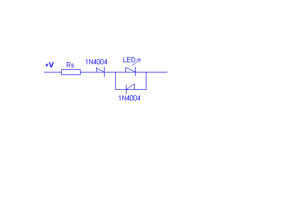

Why dont you put a 1N4004 in series with the LED, which has the reverse parallel 1N4004 across it.? Ref the gif.
Any help with a good replacement for a 1N4004 diode?
You did ask for a good 1N4004 replacement....:)

hi hero,
The application the OP describes is unusual.
IIUC he wants to detect if a 1N4004 fails by using the high current LED in series with the 1N4004.
IF the 1N4004 fails he is concerned about the high reverse voltage that could appear across the reversed biassed LED.???

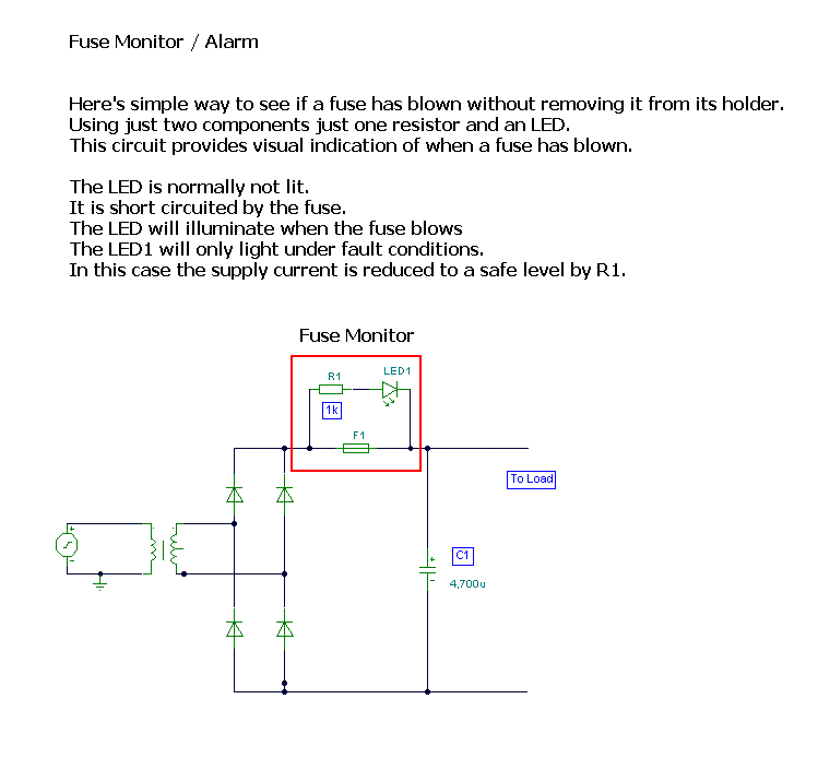

Wire the LED with another 1N400x and 2.2k/.5w series resistor across the diode in the circuit. The LED will not light, until the original 1N4004 diode fails (open), after which, the current needed for the LED will pass thru it. The only adjustment to this circuit will be to lower the value of the series resistor to increase the brightness of the LED should the circuit load not be large.
It will not detect a shorted diode, only those that open.
Hope this helps.
Jim
How about this circuit?
The fuse monitor comes pretty close to what I am looking for. It indicates the opening of a diode without introducing a series element (series elements decrease reliability).
One problem with that is, my supply is already redundant, and it is that redundancy I want to make use of. In case one of the diodes fail, the load will remain getting power from the second diode coming from a different power supply. Consequently, the LED wouldn't light till both of the diodes fail open.
What I want is to know when one of the diode fails so that I can replace it before the other one fails and unpowers the load.
Failures of properly rated diodes are extremely rare. In my opinion monitoring a diode for failure is pointless. The monitoring circuit will have a much greater likelihood of failure.
