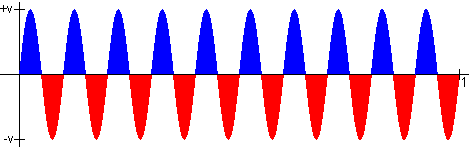

Hello,
Nigel, I have to disagree.
In 1 cycle, you have 1 crest and 1 valley (trough).
So in 1 cycle, you are going to have 2 peaks, one positive and one negative.
In 1 second with a 60 Hz wave you have 120 peaks (60 positive and 60 negatives) or 60 crests and 60 valleys. If you put a diode there, you are going to "ignore" one of those peaks, then you are going to remain with 60 crests or 60 valleys.
Take a look at a 10 Hz graph:
Hayato said:
Hello,
Very sorry, you are quite right :D
With half wave rectified AC you get one peak, and one valley (of NO voltage) per cycle (giving 50/60), if you fullwave rectify then the negative peak fills the empty valley (giving 100/120)
