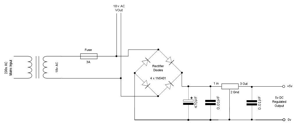

Hi all,
New to electronics but need a power supply to supply 18v AC and 5v DC. It's got to give enough power for up to 50 2.5v 30mA LEDs on the 5v DC out and enough to the 18v AC to charge a capacitor discharge unit.
I have no idea how much current the capacitor discharge unit requires.
Below is a 5v DC circuit diagram I found on the web and redrew adding the 18v AC spur.
So here's my problem.
1. How do I work out what VA I require ???
2. Will this spur addition work or do I find a two output transformer ???
Angie

You need to figure out how much current you need for your "capacitor discharge unit" - they will look like short circuits when discharged on startup so you will also require potentially allowing a large inrush current. Make sure your fuse can accomodate that. This applies whether or not you use a one output or dual output transformer. The find the proper VA ratings, you will need to work out what kind of a load that capacitor discharge unit will look like. Your 5V load is much more straightforward.
It say maximum 2.5 Amps for the CDU on a webpage that sells the circuit (I just found that).
The capacitors are 2200uf (whatever that is) and 35v
Theres a BD 909 IC on the board and I have no idea what that is either.
There's also one resistor (looks like green/blue/brown/gold = (512R with 5% tolerance) and two diodes that I can't read the values.
I assume from this I need the AC out to be at 2.5A... is that right?
If so VA = 2.5 * 18v = 45VA?
Angie

Well, you gonna need 45W, because U*i is power, not apparent power.
VA = W/PF.
Assuming a PF aroud 0,65
VA = 45/0,65 =~ 70VA.
By your schematic, increase the value of the filter capacitor, 470uF is too low. 2200uF or 3000uF are good values.
BD909 is a NPN power transistor, probably is used to regulate the output.
The resistor is not 512R, because Green-Blue-Brown is 560R, probably is used to bias the BD909.
The diodes should be zeners, to regulate the output, together with the transistor.

Unless I am mistaken, there appear to be two requirements - for an 18 vac source for a CDU (not sure what that does) and for a 5 vdc supply to power 50-30 ma LEDs.
The circuit for the 5 vdc supply shows a 470 microfarad capacitor prior to what might be a 3 terminal regulator (7805 maybe). It's possible that the ripple reduction of the regulator and the not too stringent requirements of the LEDs may be such that the 470 microfarad capacitor is good enough. You make no mention of ripple - and it may be a non-issue here. A reason not to go to a bigger capacitor is mentioned here - the current to charge the capacitor may blow a fuse.

Yep. So I have a capacitor discharge unit (as seen **broken link removed**) which apparently requires 2.5A.
50 LEDs @ 30mA = 1.5A
So I need 4A current.
If I used a 0-20 0-20V 50VA MIN CHASSIS Transformer would that be good..... or bad?

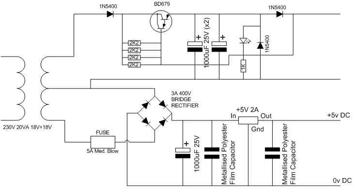

I've added an updated diagram which hopefully will get me the answer to my problem. This is now the full circuits, the regulated 5v DC and the 18v AC to 18v DC half wave.If as the diagram says I use a 18v AC - 18v AC 20VA transformer how many amps will it allow before meltdown please?

The 2.5 amp load at 0.65 power factor and 20 volts (that's what you'll be delivering) is 77 VA. The 1.5 amp load is 46 VA. The challenge - is the load continuous? If it is the answer is easy - if not and you want to get by with a smaller transformer you'll need to determine the load based on the expected operation of the circuit. Note that you can reduce the 46 VA part by going to a switching supply as it is more efficient.
