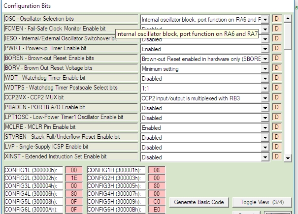

On re-reading the Data sheet, I think the PIC will work without a crystal.
I've tried setting OSCCON and PLL, but 18LF2520 does appear to be running correctly. Can anyone supple the OSCCON and PLL settings for 8MHz and X4 please.
C
You need to set OSCCON to 0x70 ( 8Mhz) and set the PLL bit in the config register.. I think there is a software bit aswell.
So config FOSC= INTIO2 and PLLEN = 1
Then OSCON = 0x70
Then OSCTUNE bit 6 needs to be 1.

I think I've got it set correctly, but it's too fast.
Can you try it in the simulator please. The SIM is a bit faster than the PCB, but still shows too fast.
There is no INTIO1 and 2 option. I used this:
Thanks, C.

What is too fast?
Waitus 1000?
Define clock_frequency 8 -> change to 32
