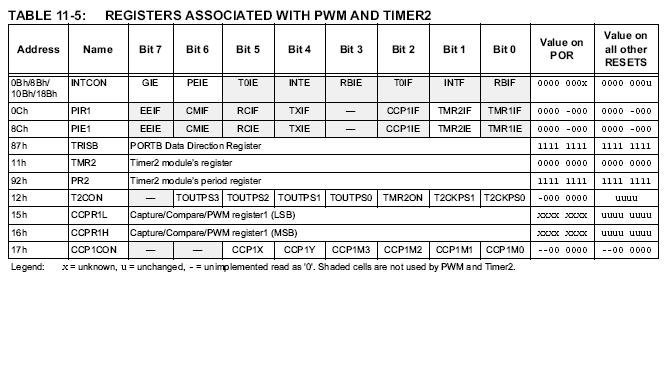

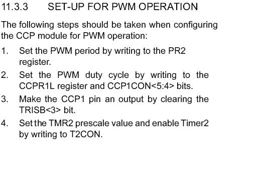

Tutorial8 needs correcting. The PWM frequency calculations don't add up. That caused WillieB to ask for help.
https://www.electro-tech-online.com/custompdfs/2005/06/33023a.pdf
page 216
i think this is wrong also
CLRF CCP1CON ; CCP Module is off
CLRF TMR2 ; Clear Timer2
MOVLW 0x7F ;
MOVWF PR2 ;
MOVLW 0x1F ;
MOVWF CCPR1L ; Duty Cycle is 25% of PWM Period
CLRF INTCON ; Disable interrupts and clear T0IF
BSF STATUS, RP0 ; Bank1
BCF TRISC, PWM1 ; Make pin output
CLRF PIE1 ; Disable peripheral interrupts
BCF STATUS, RP0 ; Bank0
CLRF PIR1 ; Clear peripheral interrupts Flags
MOVLW 0x2C ; PWM mode, 2 LSbs of Duty cycle = 10
MOVWF CCP1CON ;
BSF T2CON, TMR2ON ; Timer2 starts to increment
; The CCP1 interrupt is disabled,
; do polling on the TMR2 Interrupt flag bit
PWM_Period_Match
BTFSS PIR1, TMR2IF
GOTO PWM_Period_Match
; Update this PWM period and the following PWM Duty cycle
BCF PIR1, TMR2IF
fifth line down MOVLW 0x1F ;
is indeed 25% of the PWM Period
thirteenth line down MOVLW 0x2C ; PWM mode, 2 LSbs of Duty cycle = 10
but when you tack on the two LSBs of the duty cycle
it dosnt make any sence..
