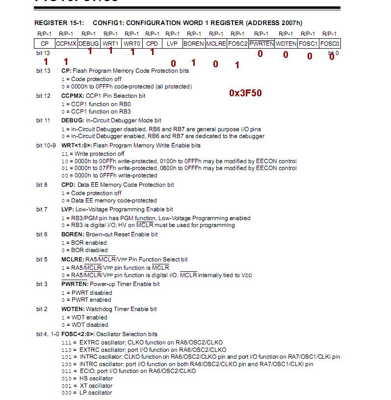

hi Paul,
Your CONFIG is set wrong, look at this image.
EDIT:
Ignore that!! the Oshonsoft says otherwise...

Hi Eric,
I tried the config using MPLAB configuration tool but nothing seemed to work.
Have you set the OSCCON register for a 4MHz clock.??
If you compile in Oshonsoft Basic and you have defined the clock as 4MHz it should set the OSCCON reg for you.??
Remind me, how you are you using the /MCLR pin ??
E.

I have got the asm file created in Oshonsoft running in MPLAB, added a suitable header.
With the CONFIG bits to 0x35f0.
I cannot see in the assembled Oshonsoft 'asm' any reference to the OSCCON setting for 4MHz.???
Try setting OSCCON in the Oshonsoft Basic program.
E.
Thanks Eric,
I would never have found that one!
Working a treat.... with Temperature reading (although not calibrated)
Regards - Paul
