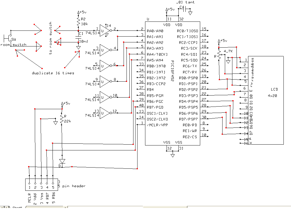

I was thinking along the lines of just using either 8 input pins or 16. sixteen would make for a very simple PIC program. Just poll all 16 inputs and which ever one goes LOW then display the switch number using an LCD or multi digit LED display. I oped for the LCD

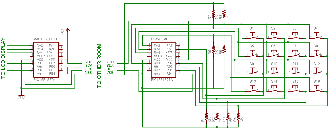

I like your idea. It's nice and simple. My idea was to have 2 PICs linked by I2C. There would be a slave placed in the room with the 16 pushbuttons. I would dedicate 8 pins to the pushbuttons and scan the pushbuttons with a 4 x 4matrix setup. For the slave I was going to use a smaller 12 or 14 pin PIC. The master PIC would be in the other room and would repeatedly ask the slave PIC (maybe once every 1 or 2 ms) via I2C to report what buttons were pushed. The master PIC would have to be a little bigger to drive the LCD display. I was also going to look into using an LCD driver IC that the master PIC could send data via I2C so I could get away with using an smaller PIC for the master as well. The 4 wire requirement of the OP would be satisfied. The 4 wires would be:
VDD
VSS
SDA
SCL

the schmitt trigger inputs to prevent switch bounce as the switches are a distance away. A cmos version? unless 74C14
one PIC, 16 N/O pushbuttons, 3-7416's, a 5 pin header (not really needed but?, about 20 resistors, a diode and a well regulated 5volt power supply. A wall wart would do the deed but use a regulator anyway.
whole setup less enclosures about $20
the LCD could be a 16 x 2 =$6
the PIC chip can be had for FREE or under $5
a perf board unless a custom pcboard (am in process of designing very similar for a tempeature sensing unit)
The hard part is the 40 pins to deal with on a perf board. much easier using a pc board with header plugs to keep things straight.
Lets see if I got this right=16 seperate switches in 16 different locations. two wires to each switch.
am contemplating a one wire scheem. I wonder if Maxium has such a beast?

2 wires per switch x 16 switches would result in 32 wires between the rooms. Even 1 wire per switch would be 16. I thought only 4 were allowed. Am I missing something here because it seems like your scheme will not satisfy the OP's requirement.

I'm still not really understanding your idea. You could use 4 wires each as one bit but that wouldn't handle multiple pushbuttons simultaneously and you would require a seperate power supply in the other room. This is what I had in mind:
There's 2 PICs each less than $2, 8 resistors mayby .05 each, the LCD, and the pushbuttons. In the finished circuit you'd need a few caps here and there and maybe some pull up resistors on the I2C lines but that's about it.

I didn't say that it was a requirement but why not if you had the capability and it was simply a matter of a few extra lines of code. The only requirement I recall was to use only 4 wires in between rooms. This does that.

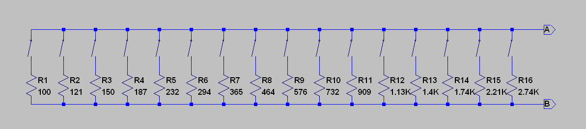

Oh good, then you will appreciate my solution: Two wires and 16 1% resistors...

Post #33 by mikemi if more than one switch is pressed then you have two or more resistors in parallel which could cause a false switch indicator.

Not with 1% resistors. There will be sufficient resolution to detect pairs vs singles. Besides, the OP never specified the need to sort out multiple buttons. Besides, I posted this somewhat tongue-in-cheek, just to get folks thinking...
I had a similar idea but you still must deal with possable parallel resistors
good idea for sure. maybe a diode to isolate each resistor??

Yes, there are 8 wires to the switches, but only 4 wires that run in between rooms. I interpretted the 4 wire requirement from the OP's original post to only apply to the wires that run in between rooms. The Slave MCU, resistors, and pushbuttons will all be in the other room so the only wires running in between rooms will be VDD, VSS, SCL, and SDA. The original post wasn't really specific so if my interpretation is not correct the OP can clarify. It doesn't really matter I suppose as the OP seems dead set on over complicating this and not using PICs.
