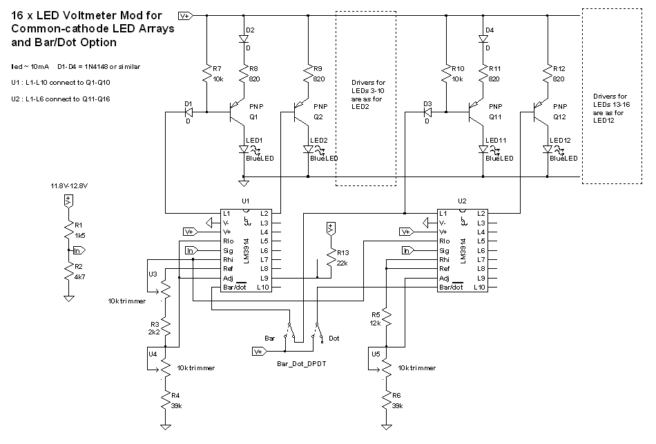

I notice PNP9 and PNP10 are shown with the e/c connections reversed in your schematic.
Missing connections? Do you mean the 20k resistor which goes somewhere... between pin 10 an 11 on the 1st IC.
What else have I missed?
The 20k (22k is probably easier to source) is missing and the dot-carry connection is not shown correctly.
Pin 1 of each IC behaves differently from the other LED-driving pins, so to enable Dot-mode the transistor driver stages for LEDs 1 and 11 need to be different from the drivers for the other LEDs.
Here's a revised schematic which provides both Bar and Dot modes (switch-selectable). Note that pin 11 of U1 has the pull-up 22k resistor to +V and also connects to a LED driver stage. The values of R7 and R10 are a compromise between allowing sufficient 'on' LED current in LED1 and LED11 and minimising the spurious 'off' LED current.
Edit: This revision should overcome the points chemelec noted with your version.

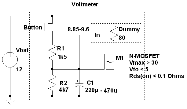

I have bridged R2 with C1, whatever the value this should slow the turn on/off of the lights right?
C2 is on the LED power source, so the LEDs will drain this for power when turned off.
So in this case would 100uF for C1 be ok? I have no idea about C2's value.
Also rather than a dpdt switch I am using jumpers, I wont be changing mode when it is on, and i will probably stay with BAR mode unless the drain is a big issue.
It's part of the solution.
You have C2 in series with the LED supply. That's not going to work.
Here's how I'd do it:-
That will give you ~ .25 sec ramp-up/down time. I think you'd find a longer period would be prettier :).

You still don't have the dot-carry connection from U1 pin 9 to U2 pin1, so the dot mode won't work properly (LED10 will stay on).
The drivers for LED1 and LED11 haven't been changed so the internal auxiliary current source at pins 1 of both ICs will keep LEDs 1 and 11 permanently on.

I think I have added the Mosfet as you indicated, the dummy resistor confused me a little, did I get it right?
So no C2 needed?
I will now google up on the Mosfet to see what it does, im sure ive used one years ago...
thanks
Gary
pin 1 [IC1] to 9 [IC2] connected
No. Pin 9 (IC1) should go to pin 1 (IC2).
I only indicated it symbolically. The dummy resistor is just that: a dummy (representing the majority of the voltmeter components), so it was only for simulation purposes. The FET drain (upper terminal in the schematic) replaces the Ground connection of everything except Vbat, R1, R2, C1, M1. The FET is being used to switch on/off the whole circuit. The +V supply of the circuit should remain permanently connected to the battery Vbat to be monitored. When the button is pressed C1 charges up slowly via R1. When its voltage reaches the FET gate turn-on threshold (a few volts) the FET turns on. At 11.8V LED1 turns on, followed by other LEDs in sequence as it continues charging. When the button is released the LEDs turn off in reverse sequence as C1 discharges (more) slowly through R2. Then the FET turns off when the C1 voltage has dropped below the turn-on threshold.
So no C2 needed?
No.
BTW you still don't have the different drivers for LED1 and LED11, and switch S2 is wrongly placed :).

Do you have Rhi(IC1) linked to Rlo(IC2) and the 'In' signal going to both pins 5?
If the 3914 resistor dividers are close to the 'typical' 12k as per spec then the trimmers should allow these target settings:-
Rhi(IC2) = 9.79V,
Rlo(IC2) = Rhi(IC1) =9.32V
Rlo(IC1) = 8.85V
What values are you getting? If they're not as above then the bottom resistors (R4, R6 in my schematic) will need changing.
If it helps, here's the schematic showing the FET connection:-

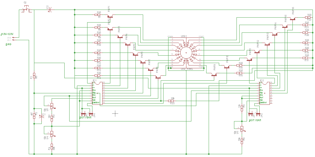

Anyway, here is the latest circuit diagram, I have sorted out the problem with the pins 9 and 1 and the MOSFET and added more resistors and some diodes as you showed.
Is this diagram now correct for the Sparkfun circular led ring?
Looks ok now.
