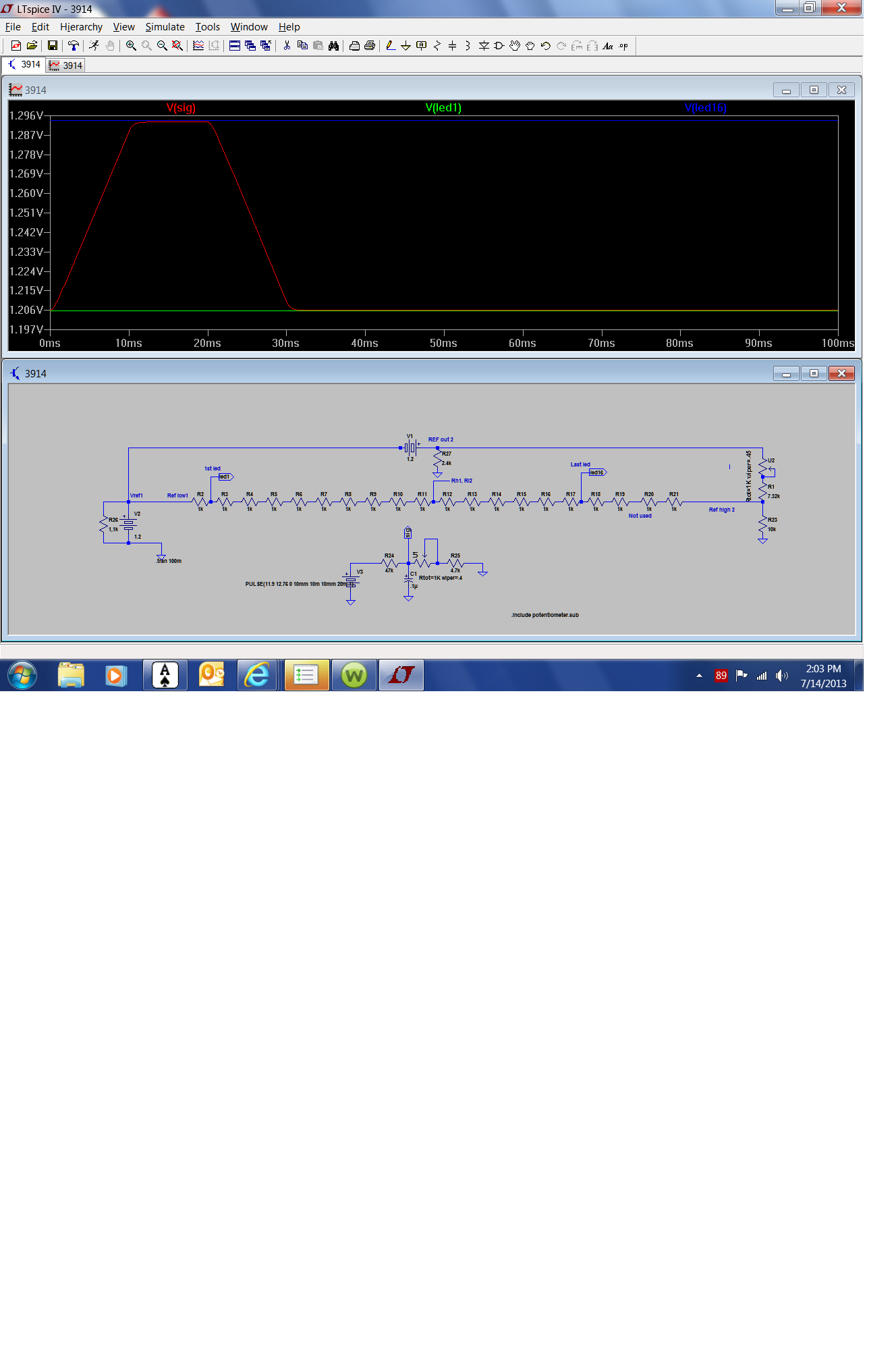

Well, I'll give it a shot. Maybe from this you can draw your schematic. I tried to label the points. Follow the other stuff in the data sheet notes. It may be a little flakey because the steps are so close together. There may be a better way to do it - not sure.:rolleyes:

Not the Voltage Range you want, But Check this out
I think the one chemelec posted is better. It has a bigger range.

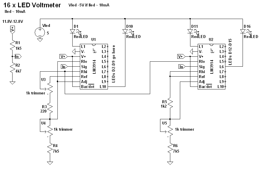

This should do it:
Note: The Rhi input to the resistive-divider has to be at least 1.5V less than the V+ supply, hence the voltage to be monitored (i.e. battery voltage) has to be attenuated. In this circuit R1 and R2 provide an attenuation factor of ~ 0.75. The Rhi and Rlo voltages allow for this attenuation. To keep chip power dissipation within limits Vled must be less than the battery voltage. I have assumed you will use a 7805 regulator to provide Vled. Necessary supply voltage decoupling is not shown (nor are all the LEDs). I have also assumed a 10mA LED current.
Here are the calculations for the post #26 circuit:-
Vref = 1.25V.
Voltage range to be monitored = 11.8 to 12.8V.
Scale factor (attenuation) = 0.75.
Scaled voltage range = 11.8 x .75 to 12.8 x .75 = 8.85 to 9.6V.
Hence Rhi(U2) = 8.85 + 20/16 x (9.6-8.85) = 9.79V
....and Rhi(U1) = Rlo(U2) = 8.85 + 10/16 x (9.6-8.85) = 9.32V.
Rlo(U1) = 8.85V.
For ~10mA LED current, (U3 + R3) = R5 = 1k2.
Hence for 9.79V at Rhi(U2), (U5 + R6) = 1k2 x (9.79 - 1.25)/1.25 = 8k2.
So choose U5 = 1k trimmer and R6 = 7k5.
Since U3 + R3 = 1k2, choose U3 = 1k and R3 = 220.
For 9.32V at Rhi(U1), (U4 + R4) = 1k2 x (9.32 - 1.25)/1.25 = 7k8.
So choose U4 = 1k trimmer and R4 = 7k5.
[Voltages should be re-calculated in proportion to the actual scale factor if the factor is not exactly 0.75.
Trimmer adjustments are somewhat interactive. Adjust them in the sequence U5, U4, U3.]

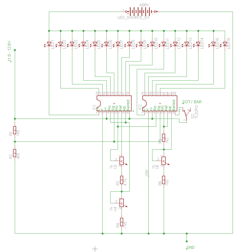

Ok so I spent a couple of days looking at all the suggested circuits and I feel like I'm starting to understand these chips, so based upon alec_T's design this circuit should work?
I have added a Dot/Bar switch, do I need another switch for the other pin-9?
Also the LED source is 5V, but I will have 12V as the source, the LEDs are 20mA or 30mA I need to check if that is per LED, but I assume it is the total of all 16 (in pairs so actually 32).
Both chips would need to have pin 9 switched if you wanted the choice of bar and dot mode. However, in dot mode there is the added complication of dot-carry (check the datasheet) to ensure LED 10 turns off when LED 11 turns on.
With R3 = 4.7k (instead of the calculated 220Ω) the LED currents for LED1-LED10 will be only ~ 2.5mA each :(
Edit: I've just checked the circular bargraph spec. If I understand it correctly the LEDs are in 4 groups of 4, each group having a single cathode pin; hence only 4 cathode pins in total but 16 anode pins. Unfortunately each 3914 IC is intended for 10 individual LED cathode connections and a common anode connection. So that circular bargraph is unsuitable for your application without drastic circuit modifications (involving the addition of 16 transistors and 16 resistors by my reckoning).
The 30mA spec is almost certainly per LED pair, and is the max rated current. You can see that in bar mode at 10mA per LED pair the display will require up to 160mA! Heat-sinking may be necessary for some components.

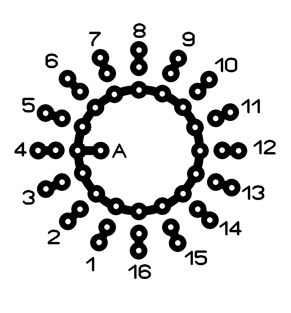

Why not just create a Circular PCB and insert your own LED's in that same pattern.
With 16 Cathode connections and only 1 Anode connection.

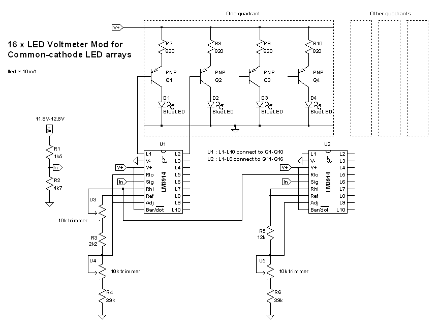

I think chemelec's suggestion is best. However, if you're determined to go with the Sparkfun display then this should work:-
16LEDVoltmeterMod.gif.
The LEDs for only one quadrant are shown. With the pnp drivers you can use a 12V LED-source instead of 5V. The LM3914's are programmed here to draw 1mA current through each transistor base. The previous resistor calculations now go out of the window because the required values are in the same ball park as the resistive dividers in the ICs. According to the spec that is nominally 12k but can be anywhere from 8k to 16k. The dividers are in parallel with the programming resistors. The values I've shown in the mod should give the necessary adjustment for the divider voltages (according to the LTspice simulation).
Here is one PCB Example I just created.
This Eliminates all 16 Transistors.

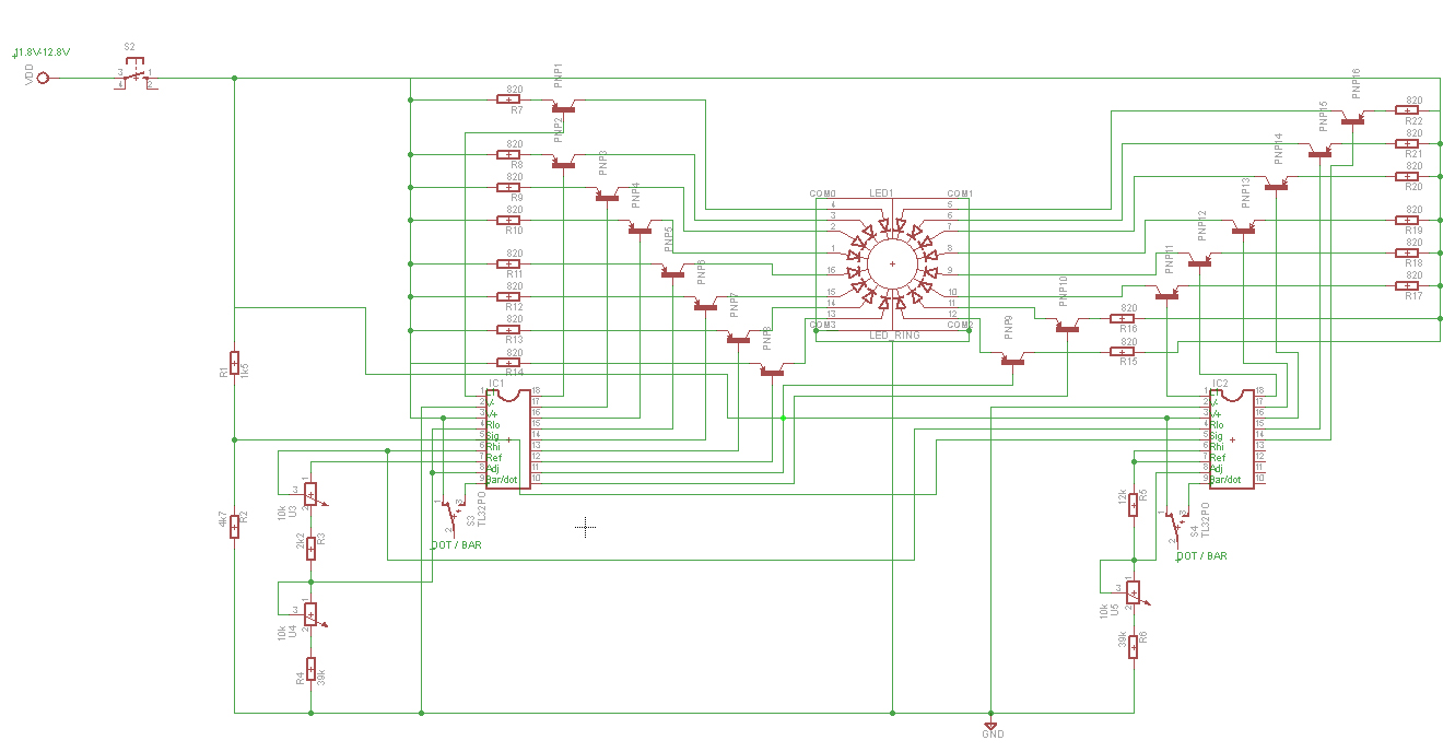

So, after Alec T's schematic I put this together.
Is this correct? If yes I will order the rest of the components and get the PCB designed/ordered.
I have added 2 switches on the 9th pins for bar/dot mode.
And a Momentary push switch so it isn't on all the time wasting the battery.
Gary
First you should breadboard that circuit, to make sure it will calibrate for the voltage range you want.
The Dot/Bar Switch should be a DPST Switch.
This will Switch Both IC at the same time.
Your schematic looks ok apart from the missing connections and resistor for the dot-mode carry (check the datasheet regarding cascading two ICs). I haven't simulated dot-mode, so don't know if the programmed 1mA current draw will allow it to work. I'll look into that. Do you really want dot-mode?
I agree with chemelec about breadboarding the circuit.
You might also want to allow space on the pcb for an extra resistor or two in series and/or parallel with the divider voltage-setting components in case the values suggested need wider adjustment than the trimmers can provide (unless you are prepared to unsolder and swap resistors). Reality may not correspond with simulation, taking component tolerances into account. Good luck with the build, but considering the very narrow voltage range you will be measuring don't be surprised if the display is jittery or drifts, because of battery voltage fluctuations under load and with temperature.

Missing connections? Do you mean the 20k resistor which goes somewhere... between pin 10 an 11 on the 1st IC.
What else have I missed?
I'm not too fussed about Dot mode.
I have added dpst jumpers to the design so I can cap them so I can see how it works once im happy I will leave it in one of the modes.
