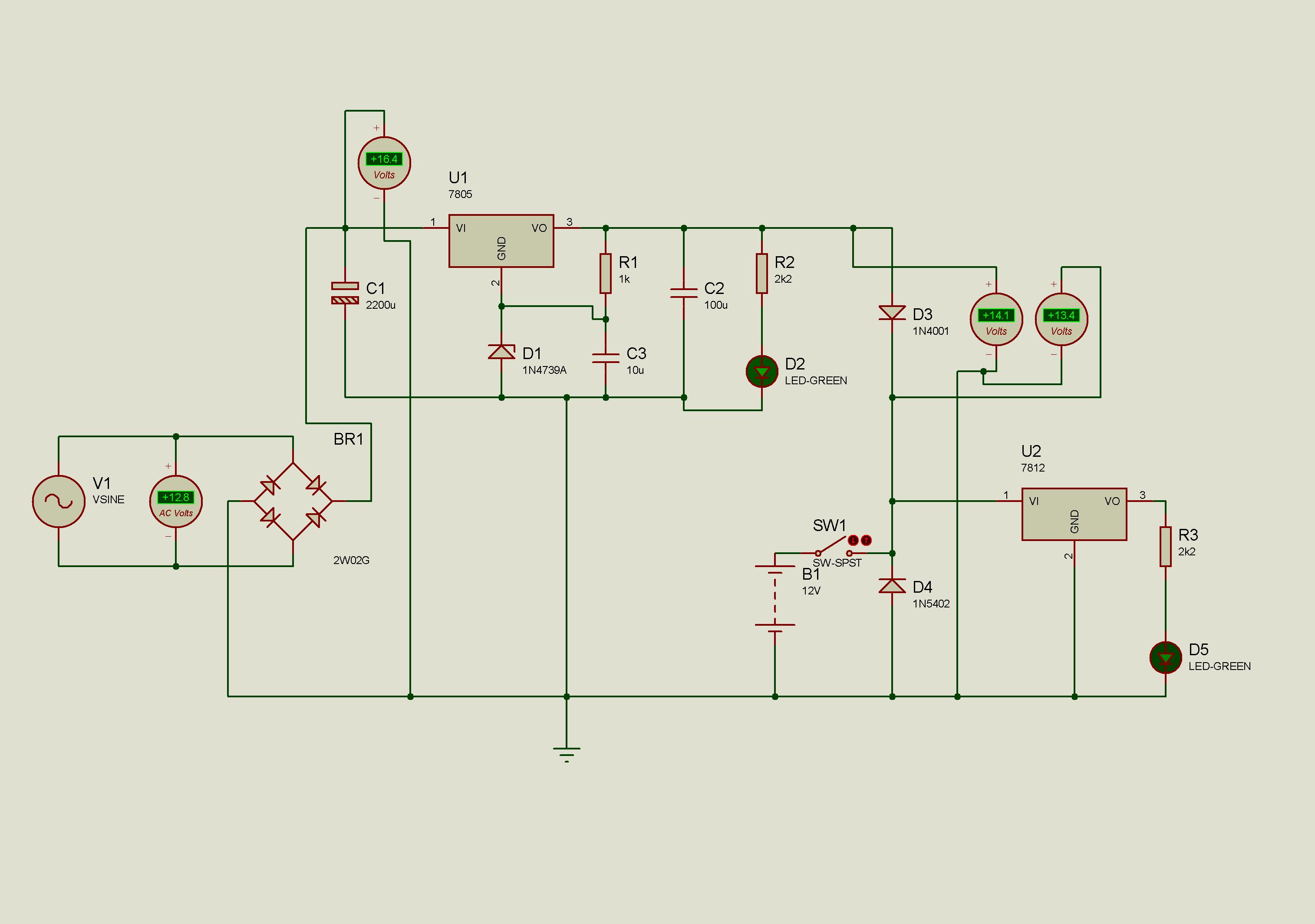

12v lead acid backup circuit
desmondlai
when i construct this circuit in pcb i cant get 14.1v and 13.4v at the point as i stimulate this circuit .... the difference of the pcb and the stimulate is the 7805 and 7812 , i replace with 78t05 and 78t12 that 3A ...
how can i get back the 14.1v and 13.4 v without changing the both 78t05 and 78t12????????

There are a few things wrong with that circuit:
U2 will go into drop out, you won't get 12V on the output but 10V at full load.
C1 is probably not large enough to avoid ripple.
You need to use a higher voltage transformer, I'd suggest 15V. The simulator doesn't simulate the transformer's series resistance or regulation factor so the output voltage will be higher with no load than when fully loaded. The sharp peaks drawn by the filter capacitor charging can cause the voltage to drop below the 16V, the minimum voltage required to keep the regulator regulating properly.
Why would you call a simulation program "silly"? Besides the human brain, It's the most useful tool in designing circuits there is. Of course you have to understand their limitations and recognize if it is producing unrealistic (silly) results, but I would never build a circuit without first simulating it. Simulation can catch many subtle errors in the design that otherwise you wouldn't find until after the circuit is built. It's also a great tool for just learning about circuits.
Simulation of the transformer regulation just requires adding a resistor in series with windings whose value can be obtained from the transformer data sheet or measuring the winding resistances with an ohmmeter.

Well, certainly any tool can get you in trouble if you blindly rely on it. That's where the learning part comes in. The preference is to learn how to use the tool properly and recognize when it is giving bum information otherwise. I believe the purpose of this forum is to help people use such tools correctly, not imply that they can not be relied on.
I have designed and simulated many analog circuits with SPICE and it almost always has given a close simulation to the actual circuit operation. It's particularly usefully when trying to determine the effect of component tolerances on circuit operation. The differences between simulation and actual are often due to parasitics, but part of the learning curve is to know when and where these need to be added to the simulation.
I know he didn't include any resistive characteristics of the transformer which is why I suggested a way to do so.
