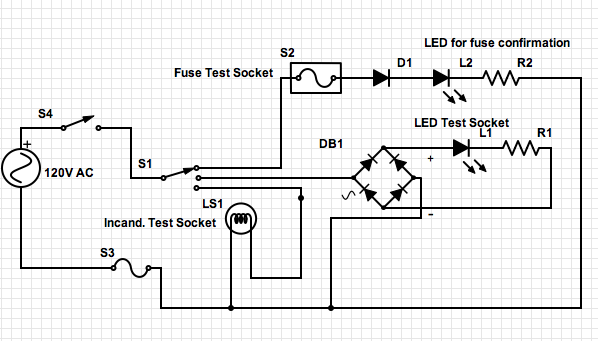

I have been asked to find a way to test parts for a little mom and pop store that sells string lights. They would like to test the individual bulbs and fuses to make sure they work before selling them. Anyhow, here are the specifications of the project and what I came up with as a solution. Just wanted to get some feedback to make sure I am going about this correctly.
1. Needs to test single LED bayonet type bulbs, single Incandescent bayonet bulbs and mini glass fuses.
2. Needs to run off of standard US AC power as their products do.
3. Should have a momentary deadman switch and selector switch or knob to choose which product they are testing.
4. Should have an additional hardwired LED to determine fuse continuity.
5. Should also have a mains fuse.
https://www.digikey.com/schemeit/#fft
Does this look correct? Should I use a rectifier for the LED test socket? Im not sure what the specs are on the bulbs that they are giving me so I have not included any values.

Yep. Maybe you could use a 12 volt DC wall transformer as the power supply. You may need to experiment with the lamps to find the right voltage and current.

Yes they are the push in Christmas light style strings. As far as using 120Vac goes, we are trying to roughly simulate the same voltage/current that they will see in use by their customers. I am assuming the 120vac LED strings are wired with two parallel 10 LED circuits in opposing directions with a 1.5k resistor wired in series. I do know there are no bridges or diodes in the LED string. I will be properly enclosing everything in a project box with a reed switch cover to make sure that contacts/sockets are not exposed to fingers when hot. BTW, the schematic has been updated from the above photo if you follow the link to the live drawing. Will this work? Thanks again.
I appreciate the feedback, and I understand the risks involved with using mains voltage/current, but is the consensus here that this is a dead project? Obviously a pure DC system would be simpler, but I was trying to come up with solution that matched the parameters that I was given. A secondary benefit was that I was hoping to demonstrate how a fully rectified LED should produce better output than the hokey AC strings that they are selling.

No, the project is ok, we are just trying to make it as safe as possible. So here is a compromise:
Use like a 12 volt AC wall adapter as the power source rather than the mains voltage?
With 1700 people electrocuted each year in the US [out of 330M], mucking around with electricity is not the most dangerous thing you can be doing.
Polarizing the plug and adding a GFCI to your circuit would probably show Due Diligence and a Duty of Care.
Single components, i.e. LED, incandescent bulb or fuse, can all be tested with relatively low voltage DC from a mains adapter. The only requirement for mains voltage AC would be to power the adapter and to test complete mains-rated strings of lights (of whatever type).
It should be possible with a few comparators and logic ICs to make a 'one-size-fits-all' tester which would both identify the type of component under test (if not obvious from its appearance) and indicate its good/bad condition.
Edit: It would be helpful if you could find out the range of voltage/current/wattage of the components you need to test, since there are so many variations of Christmas lights available.

Thanks you all very much for all input. I talked to the owner and they agreed to let me power this project with 12V. Whew, this simplified things significantly. The updated schematics can be found below. I also figured that both types of bulbs are 6V and the incand bulb burns .48W. I would appreciate one last look by some experts to check my math and design. Thanks again!
The top circuit apparently does not provide mains isolation so would be DANGEROUS.
R1 and R2 are much too low in value. At present you would have ~100mA going through the LEDs and D1. They'd die
Personally I would double the value of R3,R4. The C3 voltage will be ~16V and the LEDs are being pushed towards their ~30mA (assumed) max.
Will do, I was trying to compensate for the voltage drop due to the rectifier, but a higher value couldn't hurt anything.
