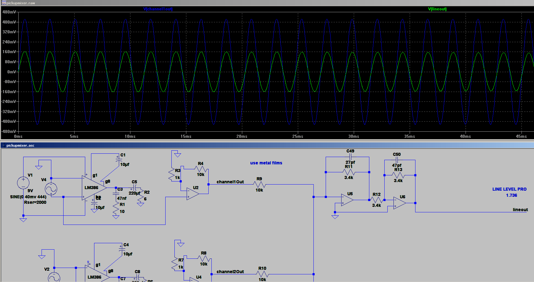

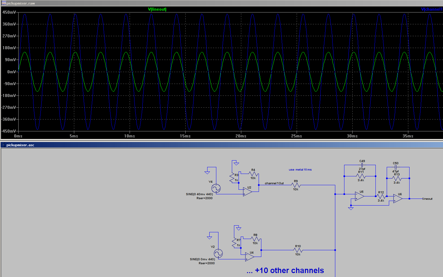

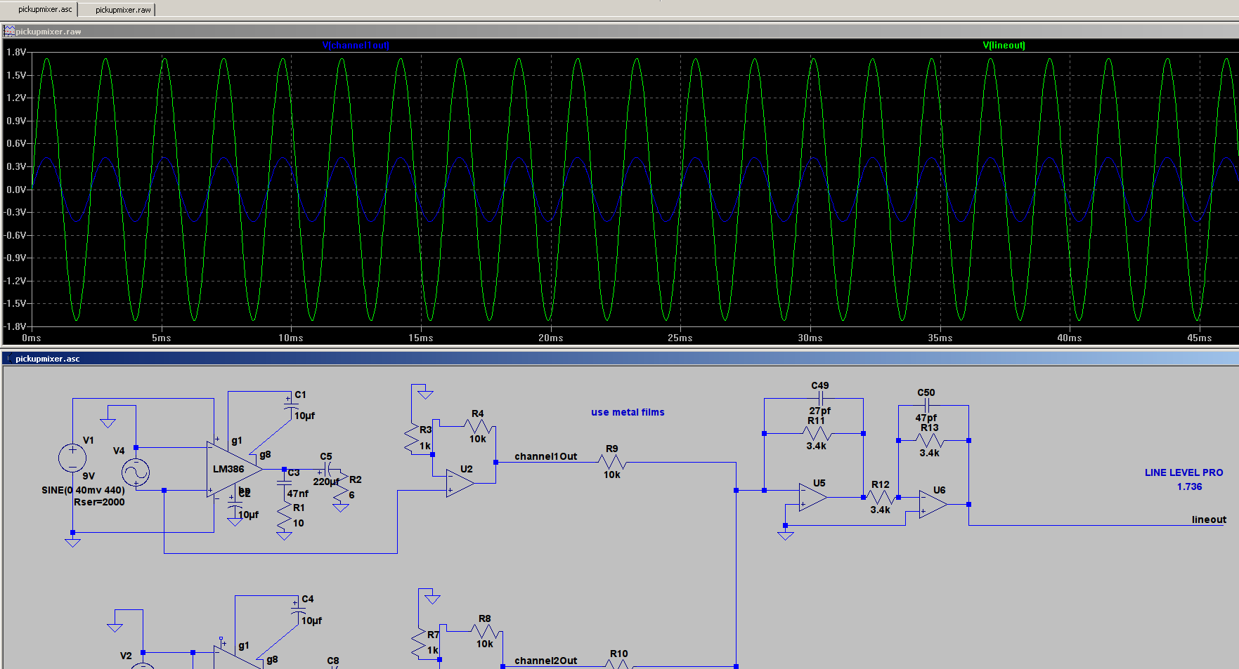

I am trying to build a "simple virtual earth active (op-amp) 12 channels mixer". The problem is the attenuation is around 20db (log(12) * 20). I don't know much about audio & electronics but using ltspice I can see that if only 1 channel is feeding the mixer, I will get a very low level output (1). But if all the channels are feeding the mixer now I have the line out level (2) that i want. Is there a simple solution to have line out level no matter how many channels are feeding the mixer? Are we talking about compressor / limiter?

The input is 40mV peak. The LM386 power amplifier has a gain of 200 so its output is clipping like crazy. With its 9V supply and 6 ohm load its output clips at about 2.3V peak then its maximum allowed input is 2.3V/200= 11.5mV peak.
U2 has a gain of 11 so its output is 40mV x 11= 440mV peak as shown on your first graph.
U5 has a loss of 3.4k/10k= 0.34 so its output is 440mV x 0.34= 149.6mV peak.
U6 has a gain of one so its output (line out) is also 149.6mV peak but is shown as 160mV peak on your first graph.
If two inputs feed the same signal to the mixer then of course the output level is doubled.
If ten inputs feed the same signal to the mixer then of course the output level is ten times but is shown as 1.7V peak on your second graph.
A compressor/limiter has an attack time so there will be a loud blast before the level drops to what you want, then a moment of very low sound for the level to return for a single input.
What on Earth (or on another planet) produces ten IDENTICAL sounds? Not musical instruments and not people singing.

It's for a guitar with 12 strings / 12 pickups, if only 1 string is playing the attenuation of the mixer is too large (20db), I am calculating the output stage to have a line out level (1.76V). I removed the LM386 (i wanted to maybe have x12 of them with speakers, but won't go in this direction). I use 3.4k in U5 so that if all strings are playing the level will be 1.76V. Here's the corrected simulation showing only the valid circuit (2 / 12):
Maybe there's no simple solution when using that many channels?
The simulation assumes that all 12 strings of the guitar are playing exactly the same frequency and phase which is completely WRONG.
The frequencies will all be different (their harmonics will even beat against each other) and the phases will also all be different. Then they do not simply add.
Briefly and occasionally they all might add but you might not notice.
I think you're best to work to a "worst case" scinareo - assuming that you are getting the maximum expected level, in phase, into all your inputs at once. That way you can be sure that your mixer amp won't clip under any real-signal condition. You're right that just a single input will give a very low output (relative to all inputs driven), but that's just the same as the difference between playing one string and all of them at once. Don't worry about it!
Also remember that the guitar gives a very wide dynamic range output anyway, depending upon how its played, so your circuit will have that to deal with in any case. You may find that you wan to add a compressor at some stage, but they can be difficult to design.
