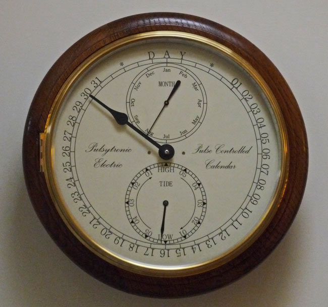

I have almost completed the basic design and look of my calendar & tide clock. This will be driven by my master clock.
https://www.electro-tech-online.com...lock-with-7-seg-led-displays-hourly-ch.18901/
https://www.electro-tech-online.com/threads/synching-quartz-master-clock-to-dcf77-msf.93022/
The enclosed pic is a mockup with the dial printed on paper and the hands laid on the dial. I may change the hands depending on what I can get/what I can file off.
The days are displayed using the min hand of a 30sec movement. The hand steps 120 times per revolution and will require 3 pulses at midmight to step to the next day. At the end of the month it will require 30,31,32 or 33 pulses to set it back to 1 depending on the month/leap year.
The month is displayed using a standard quartz movement with the quartz driver cut out so I can step it using pulses. The second hand is used and at the end of each month will need to be pulsed 5 times to step to the next month.
The tide is displayed using a tide only movement so can be driven from the 1 sec master pulse with the quartz driver cut out as the month movement above. Most tide only clocks include the seconds hand but I may leave this out on the final design.
I have most of the parts now and will build the clock and run it manually until I figure out how to link the day & month into my master. The month should not be a problem as I can configue it to step when the days have reached the end of the month. The days will be the biggest problem as they vary each month/year.

The actual clock case is almost complete. I got an old 12" Oak dial clock surround off ebay and have built a back box in Oak to match. I have bleached the Oak surround to make it a bit lighter and have cut in a new brass bezel and dial blank.
I should have the new dial painted and "lettered up" over the weekend ready for the clock control switches to be mounted. Once the new hands have been cut & filled to shape I will be ready to start thinking about the electronics in detail.
I'll post a picture when this stage is complete.

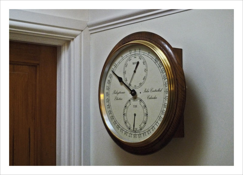

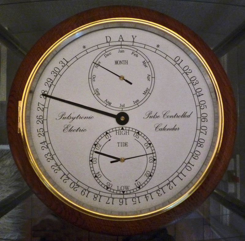

The case is now complete and all the movements have now been fitted. I am still waiting for the main day indicator hand but have moded an old hour hand for now. The movement for the day hand needs spacing back a bit as it sits too far forward from the dial.
The 2 quartz movements have been moded ready for the PIC circuit and switches. The tide clock is running off quartz for now and is set to show the tide at Middleton on Sea Sussex.
I'm off now to read up on PICs. The basic code I have is for a 16F628A but my Junebug works with a 18F1320 so I'm hoping there is not too much to change.

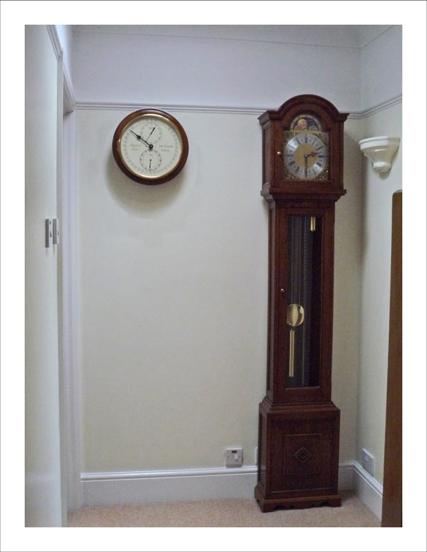

Enclosed a few photos of the calendar clock in rough position in my hall.
The longcase clock in one of the pictures is where my master driven electro-mechanical chime is hidden(the longcase clock chime is disabled).
