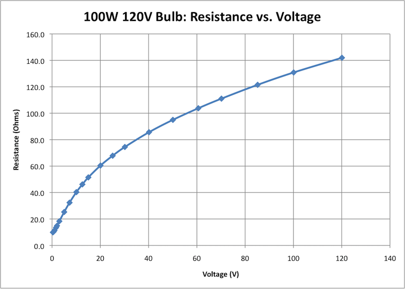

It is bleeding a 100,000uf 50V cap in a mig welder that I am converting from AC to DCEN. I can use a small bulb. It will be inside the welder cabinet. Actually, I guess the easiest thing to do is just use the 100W 15ohm bleeder I have and put a meter across it once and see how long it takes to bleed it down and just make sure I hold the switch down that long whenever I'm done. I'm using the switch because I don't want the caps to discharge each time I let go of the trigger but want to bleed it when I'm done. The light just provides visual confirmation. I'm not an EE so this is related to this post. https://www.electro-tech-online.com/threads/momentary-switch-and-led.121208/page-2#post-1346083

I would expect a 110v 100w bulb to take around 0.9A (at 110v) and as V=IR or R=V/I then maybe 120R ?

Bulbs aren't resistors - and the resistance at a much lower voltage will be MUCH lower than that at it's rated voltage.
This is why old bulbs commonly blew when turned on, as they take a large surge before they warm up and their resistance increases.
If you stick a meter across a cold bulb you can easily measure the cold resistance.

The resistivity of tungsten varies with temperature, roughly 0.4% per degree K, so the resistance of an incandescent lamp at its operating temperature of roughly 2800K is much higher than its cold resistance.
I made some measurements of I vs. V on a few incandescent light bulbs and plotted their resistance versus voltage. For a 100 watt, 120 volt bulb, this was the result:
I've just measured a 100W 240V bulb resistance and yes, it is pretty low at 40R (took me ages to find an "old school" bulb) so with a 100W 110V bulb a 10R would be perfectly feasible (I stand corrected).
