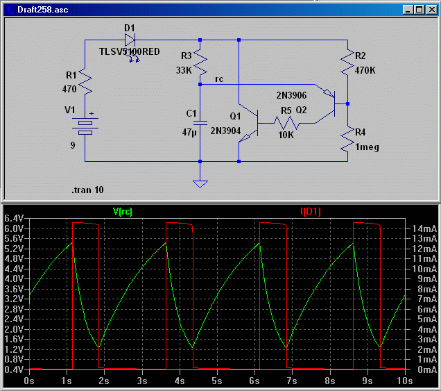

Here is the simplest LED flasher I know: It is a lot of parts if you need a hundred of them...

The transistor emitter-base with collector junctions have a fairly high voltage avalanche breakdown which produces negative resistance and is active enough to make the LED flash on and off when powered from DC.
Your low voltage zener diode has a poor zener action and does not have any negative resistance. Your circuit is completely different with a small value capacitor in a different location. Your circuit is powered from AC, not DC.
Therefore your circuit WILL NOT WORK.

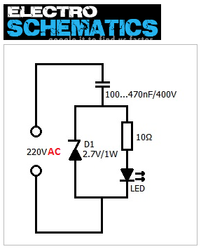

I found the LED circuit you found. It operates the LED from the mains so it turns on and off at 50Hz and appears to be continuously lighted.

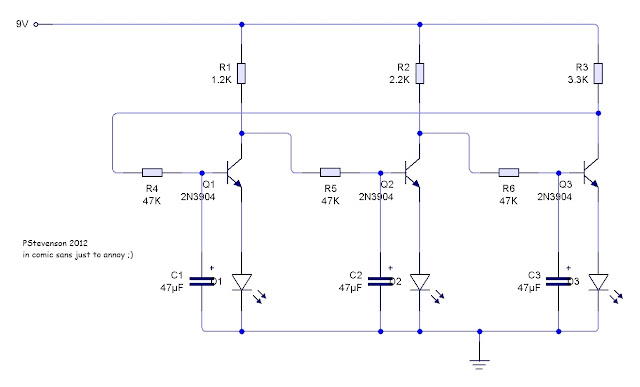

I tried the a 2N3904 transistor, the Red LED Flasher does not work on 12vdc or 15vdc.
