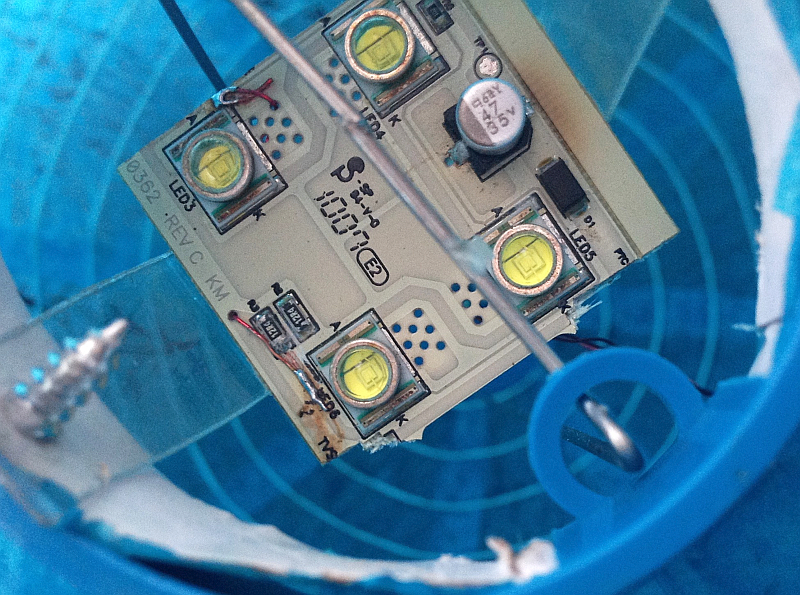

And One more thing I need to know about transformerless capacitive supply for this module. How far should I do to build the circuit without using power transformer as used in mobile charger.

LM 317 has the output current of 1.5A and LM 338 has the output of 5A. So the current requirement is only 350ma for this module and LM 317 can give. Or, is it like when voltage is increased the current also increase proportionately!

Use a CPU heatsink with fan and connect all in series. Use a small 1R in series direct or power N_ch MOSFET on low side.
Your LED may consist of 3 or 4 chips in series ( each with a Vth of 2.85V ( very dim)
If they get hot, the voltage will drift down. ( Shockley effect), and thus draw more current.. so dont let them get too hot to touch.
You can monitor current with a 50mV shunt R or current meter and direct connect them or use a power MOSFET with < 100mΩ RdsON on the low side.
Since 3 units range from 30~36V, you can expect the MOSFET to need a Heatsink mount.
I do this all the time as well as connect the 10W LEDs direct to PC PSU 12V with a 50mV current sense shunt to verify quality of LED. Often long cable R gives the desired calculated current limit from a fixed V.
These run off 12.0V SMPS at desired current with no other parts connected with 30AWG magnet wire to 18AWG feeder. ( the other parts on board not used) on MC-PCB which has microvias for improved resistance.
I chose ~5W so they sufficiently bright and cool with exactly 3.0V per LED.
