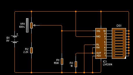

here you go, vr1 should be 6.5MΩ or equivalent to the P.D.

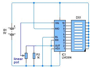

Nice try, but an LM3914 doesn't work like that:
1) Your extremely high value pot has an odd value and its resistance is much too high.
2) The battery voltage changes as the battery voltage runs down, and if the pot is connected to the battery then the display to also change.
3) With the voltage reference's output connected to the adjust pin, the reference voltage is 1.25V and since the RH is connected to the 1.25V then your display would indicate max for most of the rotation of the pot.
4) A resistor is not needed at the lower pin of the pot.
5) A resistor is not needed in parallel with the pot.
Instead, it should be connected like this:
1) Any linear pot can be used from 10k to 1M.
2) The pot is connected to the 1.25V regulated reference voltage that doesn't change.
3) The pot will control the display linearily, from zero to max.

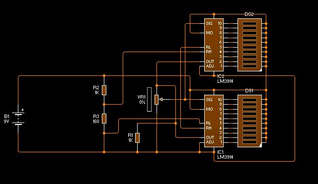

try this curcuit then it works perfectly and for the 160Ohm resistor just make one up from smaller resistors and it doesnt matter whan size VR1 is!

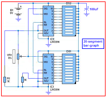

Hi Daniels,
160 ohms is a standard 5% value.
You are clever to use 20 steps in your bar-graph circuit. :lol:
Your sim isn't smart enough to know:
1) The voltage of the battery will drop over its life and since a divided version of the battery voltage feeds the RH and RL terminals of both LM3914 ICs in series, but the pot's voltage is regulated, then the display will read too high as the battery voltage falls.
2) You have the OUT terminals of both ICs connected together with a 1k load resistor common to both. Therefore the IC with a slightly higher reference voltage will be bright because it will have current in the 1k resistor but the other IC with the slightly lower reference voltage won't have any current and will be extremely dim.
You should have only one IC supplying a regulated 1.25V to the pot and the series'd RH and RL like this:

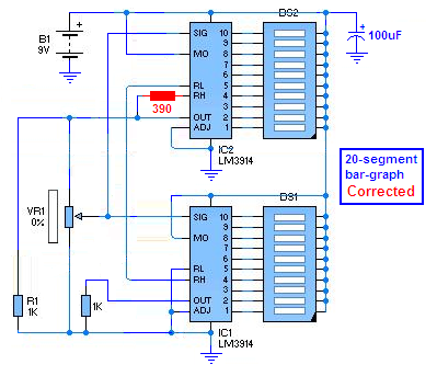

danielsmusic said:
hmmm. your design doesn't go up to the top bar. :? why is this?
Hee, hee. :lol: Because your stupid sim program is smarter than me! :lol:
I forgot that the top bar lights only when the SIG voltage exceeds the voltage on the upper IC's RH pin. :oops:
Since the total resistance of both dividers is 24k and the max input offset voltage is 15mV, and the switching between bars needs another 5mV for them to be bright, then 390 ohms added in series with the divider will provide the required 20mV.
