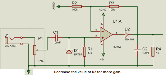

    since we're on the topic of zeners... see this circuit:
    http://www.electro-tech-online.com/attachments/e-drum-preamp-png.33856/
    This circuit is proposed by audioguru for my disdrometer project
    http://www.electro-tech-online.com/threads/acoustic-disdrometer.98174/
    How does that zener clamp the output from a Piezo transducer?

    I was wrong.
    The BAT85 is a Schottky diode, not a zener diode.
    It conducts when the input goes negative by only 0.2V to avoid destruction of the input of the opamp that has a max allowed negative voltage of -0.3V.

    okay.... so a Schottky diode it is.. can it be replaced by the IN- series? Like the IN4148 or IN4001?

    The Schottky diode has the required 0.2V to 0.3V forward voltage to stop the negative input to the opamp from exceeding its max allowed negative voltage of -0.3V.
    An ordinary diode has a forward voltage of 0.6V to 0.7V so the input of the opamp will be damaged.
