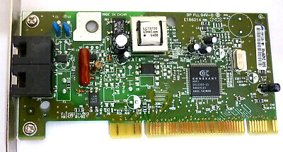

Audio transformers for telephone modems are usually 1:1 and pretty good at audio as the modems needed quite wide bandwidth with good frequency response and linearity.
See if you can find some old 56K (V92) modems for people who have not thrown them out?
A typical example on ebay, the transformer is obvious:
You would need two identical transformers at either end with the windings in series to simulate a centre tap, as they are usually single winding each side.

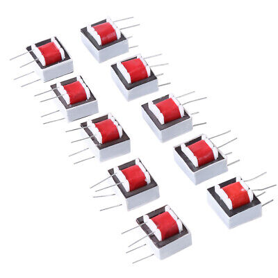

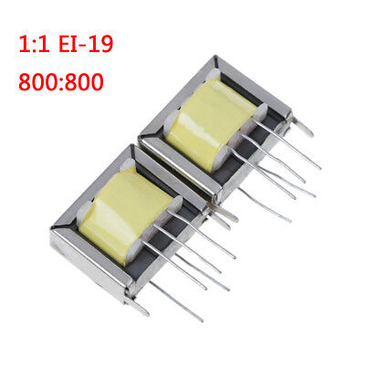

You can also get cheap generic 1:1 audio transformers on ebay, eg:
Or with centre taps, so only one needed each side, but a bit more expensive:

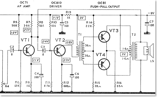

I suspect you're a little confused about resistance and impedance?, I presume the Ebay ones will be 600 ohm IMPEDANCE, and a far lower resistance than that.
This is a brief spec. from a VERY (you don't want to look!) expensive 600 to 2.4K transformer from RS Components:
Primary Impedance150 Ω, 600 Ω
Secondary Impedance2.4 kΩ, 600 Ω
Primary DC Resistance15 (Primary 1) Ω, 15 (Primary 2) Ω
Secondary DC Resistance74.2 (Secondary 1 and 2)Ω
Notice how low the DC resistances are. The actual turns ratios are:
Turns Ratio1+1:2+2
Essentially you don't wind a transformer to get the impedance you want, it's basically just a function of what impedances you connect to it - so if you have a 1:1 transformer with a 600 ohm load on it, then the primary impedance will be 600 ohms. In you then make the load 6000 ohms, then the primary impedance will be 6000 ohms.
Obviously there are restrictions in how far this works, and you need a certain number of turns in order to achieve your desired result, but that should then work over a pretty wide range. Obviously if you only had one turn on the primary, and one turn on the secondary, then it wouldn't work terribly well for an audio transformer - but would be fine for a high frequency RF transformer. Likewise, while your 3400 turn transformer works OK at audio, it would be worse than useless at high frequency RF.
