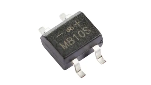

Yes, you can connect LEDs directly to an audio amplifier output signal without any external supply and they will work superb. If you do it right.
The audio fed to a bridge rectifier
and its DC voltage turns on a led trough limiting resistor and the next led is fed by a diode in series. Done it many times and gave away to friends that enjoyed them. Somehow unable to attach the photo of the gadget. :(
Edited, added image above. By my thumbnail is the rectifier in whitish.
The audio fed to a bridge rectifier (oscured at the bottom)

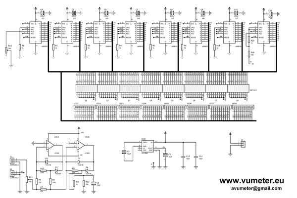

I don't know what components your circuit actually consists of. Anyway, let's talk about a general case. Without an amplifier, I do not think the signal strength will be enough to drive an LED. You will need an OP-AMP or transistor to amplify the signal strength. For audio activated LED projects, I find LM3916 the most convenient. LM3916is a Dot/Bar Display Driver. It's known as the VU-meter IC.
The LM 3915 and LM3916 LED drivers are obsolete and not made anymore. Fake or defective ones might be available.
