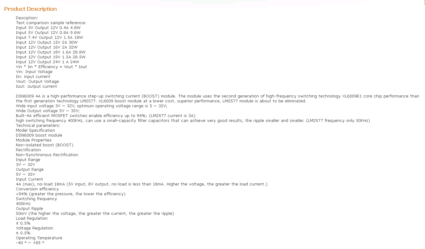

One option is to use one of these converters.
Connect to the converter input to the nominal +12V of your main battery output wiring, via a fuse and a blocking diode and the converter output to the 12v SLA battery, via a fuse.
Set the converter Vout to 13.8v , the 'float' charge voltage for a 12V SLA.

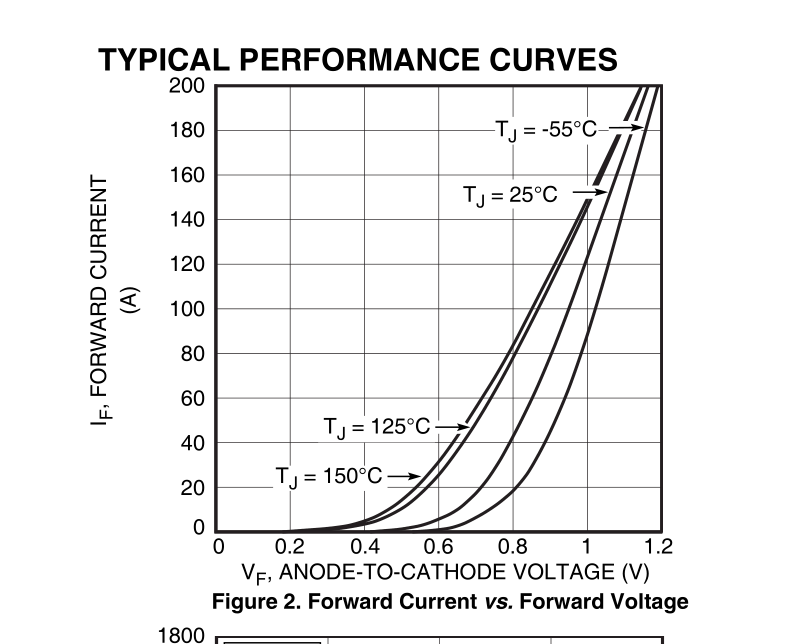

Another easy way is to use a 50A diode to drop V alternator=~14.2 to 13.8V to 13.5V
https://www.digikey.com/product-detail/en/microsemi-corporation/APT60S20BG/APT60S20BG-ND/1494822
Since cathode is on back. if you clamp to frame ground for a heatsink and electrical connection then you only connect Anode to Vbat- and then Vbat+ to car Vbat+
900mV @ 60A
