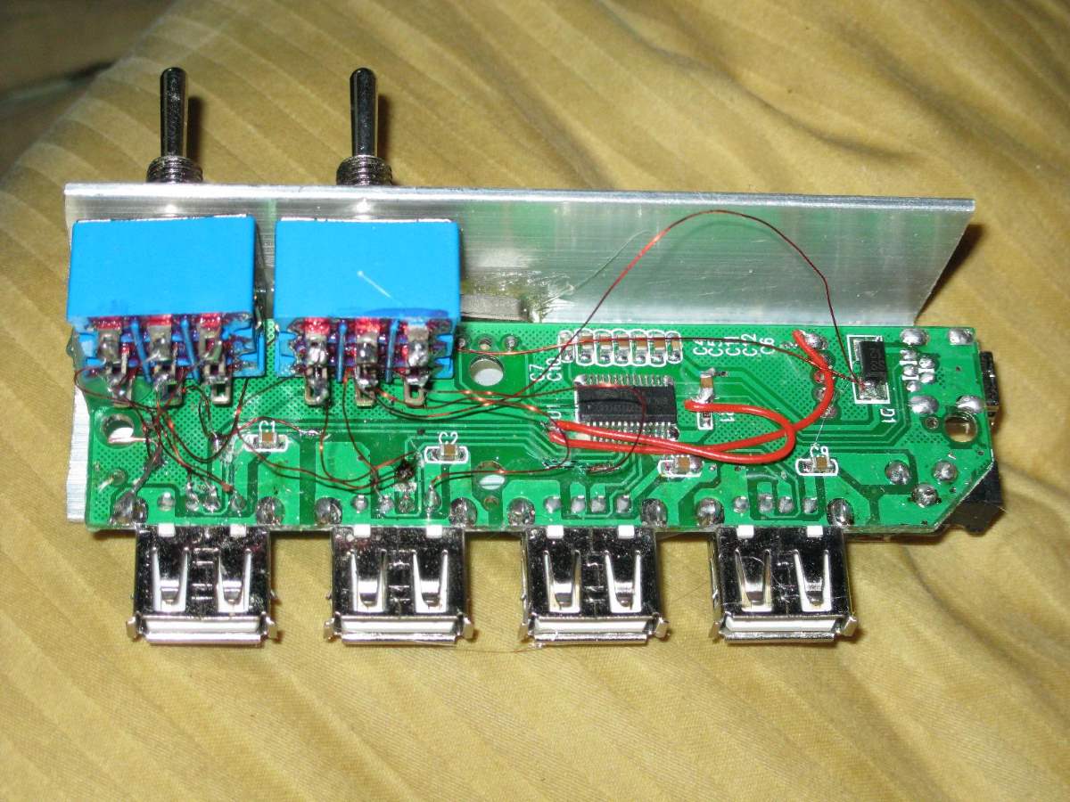

Hi again,
Here is a clear picture of what was done. The box was bought because it had to be bigger than the original USB hub box.
The switches and board are mounted on an aluminum L bracket.

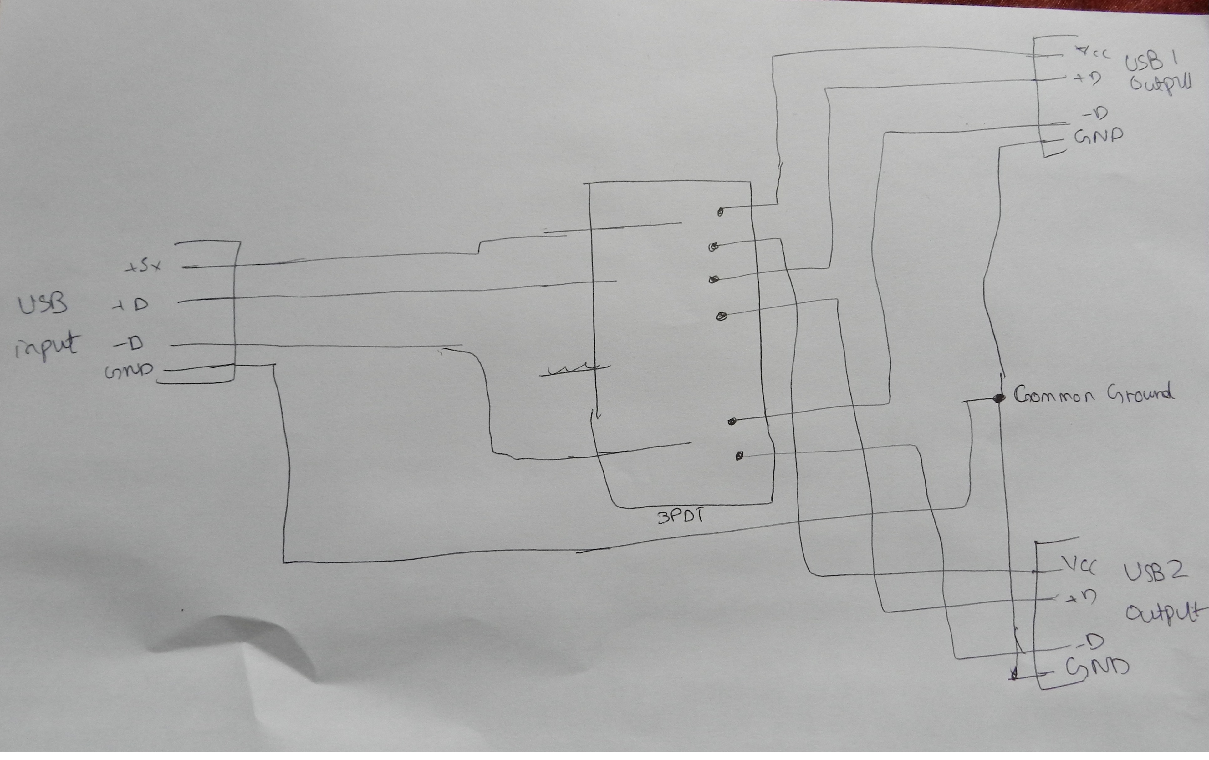

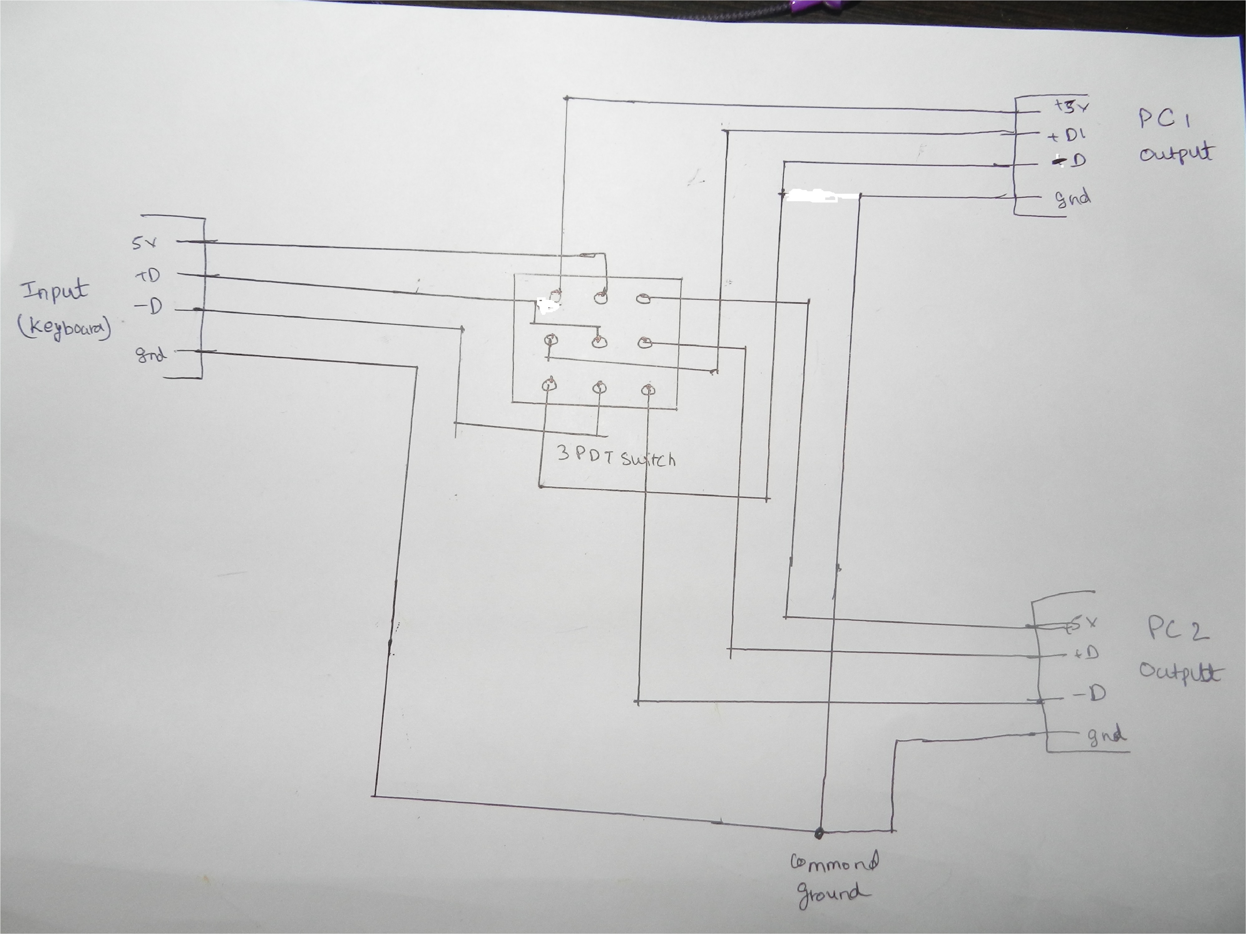

MrAl I have no idea what you want me to do.
How does this circuit look?
I dont think it could be any more clear.
Do you have a 10k resistor?
But your diagram, the switch is not labeled as to what terminals are which. You have to label them as to what terminals are what poles, etc., if you want it to be checked.

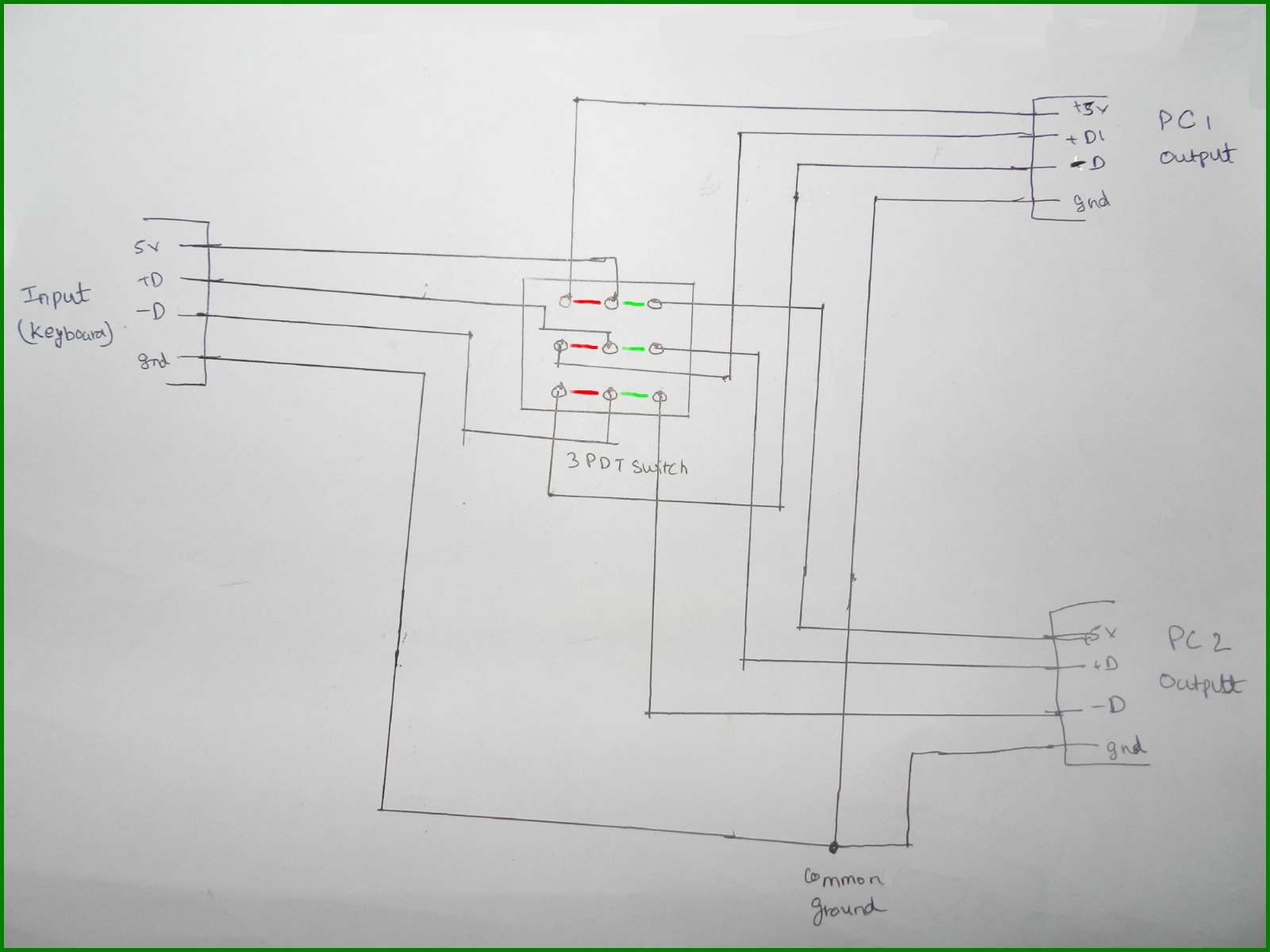

MrAl Does this circuit make any sense?
Hello,
Very good. I just added the way the switch actually switches to make it clear.
Red is when the switch is flipped one way, Green is for when the switch is flipped the other way.
Yes, as long as you have it wired as the drawing i posted. You have to show the internal switch arrangements when you draw a multiple pole switch.
