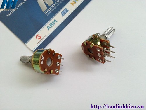

I also ask how to make potentiometer more linear (less logarit)? Linear pot not availabe or to luxury for me. I asked my brother he said add a resistor in parallel with value approx 20% of pot. maxium value but I fell it only more linear a little (I calculated then drew a graph and result this graph only more linear than old graph of pure pot. a little)
Our hearing's sensitivity to loudness is logarithmic not linear so we can hear very faint sounds and very loud sounds. Therefore a volume control should also be logarithmic. Connecting a resistor from the slider of a linear pot to ground helps a little.
I do not know why you cannot buy a common logarithmic volume control.
Of course, resistor from "output" of pot. to the ground.
I can buy normal volume control easily and cheap, I have 4 dual 100K and 1 single 10K and 1 dual 50K. But ALPS pot. too expensive and hard to buy.
