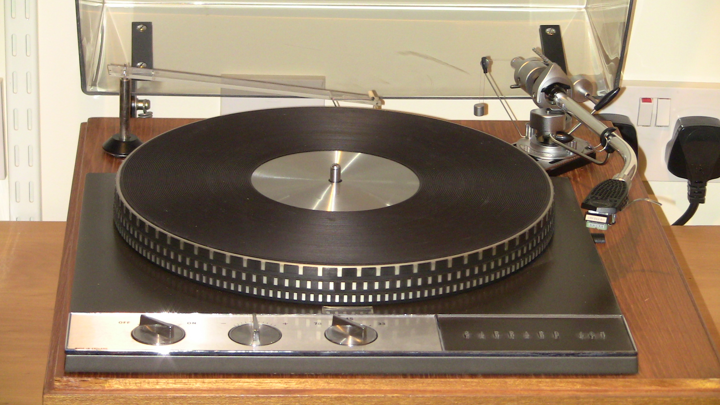

Shure V15; what a beauty. Trackability was Shure's ad line for that baby. That was the first audiophile cartridge I heard. One of the old boys in the lab was a hifi guru. I didn't know anything about amp design in those days and used to listen to his deliberations with great intrest.
One lunchtime he invited me to his bungalow, which was 5 min from work, to hear his system. He had a Garrard reference turntable with a platter that weighed a ton, and a V15 mounted in a SME arm. His speakers were KEF Concertoes driven by an Armstrong amp. None of his system was home made. What a sound! I was astounded. Being a junior person with wife and kids, a system like that was completely out of reach. The V15 is very much like the later affordable moving coil cartridges- very ariticulate, open, and natural. It's still a favourite with me.
Yes, classic hifi fetches big money these days; the turntable below £2,300 for example- no arm either!

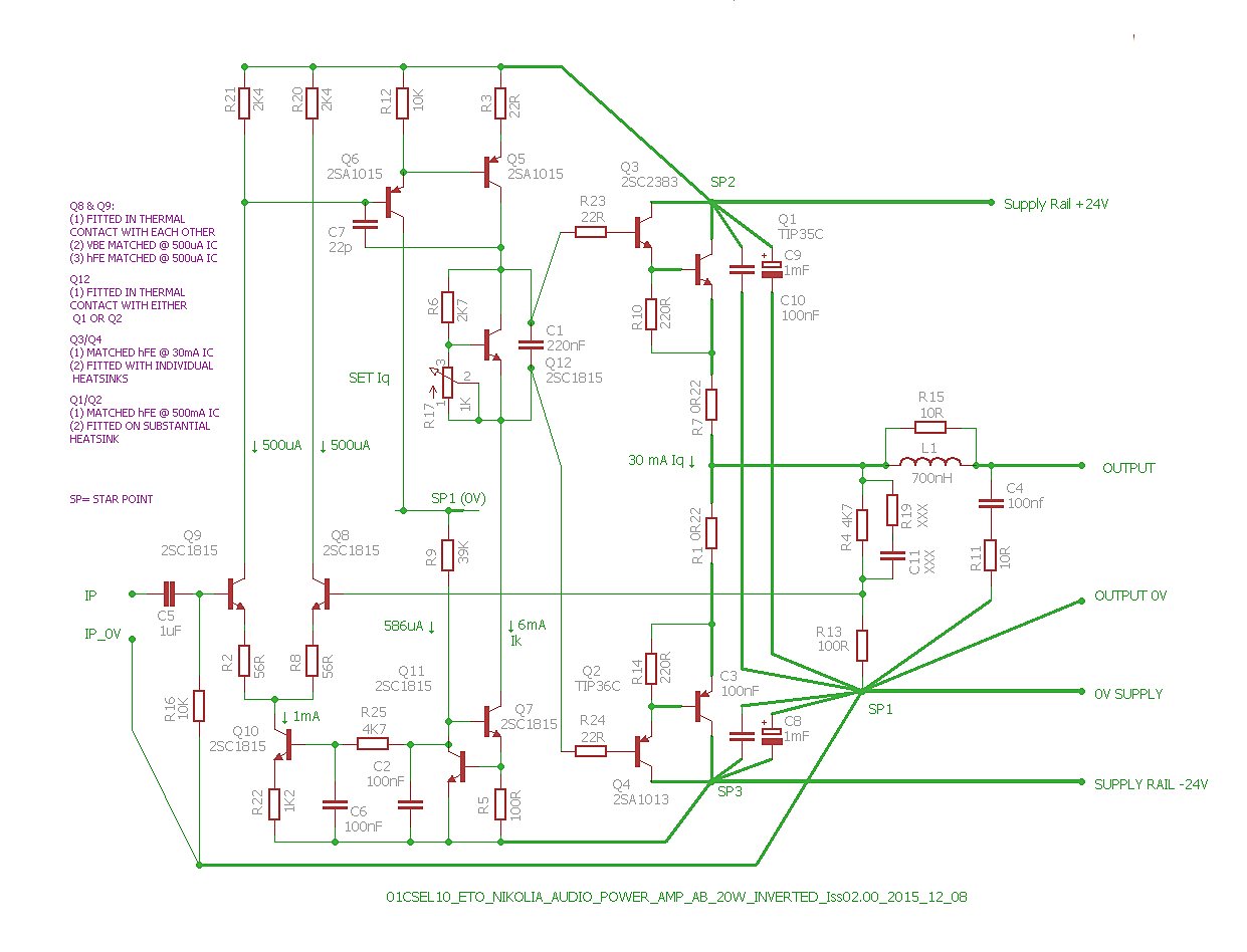

I will try to collect from anythings I have
I will replace c1815-a1015 with bc337-327 because they are better
(bc549-559 if I can buy)
2SC1815 & 2SA1015 are good transistors with 60V VCE. The BC337 & BC327 are only 50V.
The only transistors that handle substantial current are the output transistors and their drivers.
The VAS transistor pair handle 12mA top (Q5) and 6mA bottom (Q7).
The emmiter follower (Q6) driving Q5 handles very little current, but needs to have as higher ft as possible and good at operating at low currents.
The two input transistors only handle 500uA.
Q10 is only a 1mA constant current generator but it needs to be a low capcitance, high frequency type.
The rest of the transistors are not critical and you can use what you want, within reason.
BC549 & BC559 are only 30V VCE which means you would need to reduce the amp supply lines to +-15V
The variable resistor to set gain?
No. The variable resistor sets Iq, the quiescent current (no signal) flowing thru the output transistors, Q1 & Q2. This is adjusted to around 30mA to minimise cross-over distortion. The amp voltage gain is set by resistors R13 & R14: A= 1+ (R14/R13)

PS: amp schematic has been updated to issue 2: only minor mods
