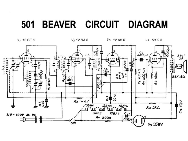

They didn't call that topology the "suicide box" for nuttin'.
Take a look at This Schemo. If you plugged that in so's the hot side went to the plate of the 35W4, no problem. However, if you connected it the other way, nothing would change as it would work just the same, so you never know when you guess right. But, in that case, the chassis would be hot to any ground. Come between the chassis and that ground, and ZZZZAP! Also, notice the use of a SPST power switch. If the hot side is connected to the chassis, the chassis is still hot to ground even if the set is switched off.
Here's another one: take a look at This Vid. Pay close attention when he shows you the bottom of that radio. See those two screws on the bottom? These are in direct contact with the chassis, and will go hot to ground. Picking it up, even if turned off, could be a shocking experience if you're also grounded.
For a radio or TV set, it doesn't make any difference since the internals can be isolated. However, that wasn't the only devices operated straight off the mains. The Lafayette KT-92 amp kit (circa 1959, schemo @ 1:25) also used a straight from the mains PS. That's especially bad since you have no idea what the end user is going to plug into it. How many CD players, computer sound cards, tuners, and so forth can stand up to 120Vrms? Low power guitar practice amps likewise were made like this, and there were electrocutions and near-electrocutions from hot guitars. For amps, a PTX-less power supply is a REALLY bad idea. It was a bad idea then, and it hasn't improved with age.
An isolation transformer is a helluvalot less expensive than a trip to the emergency room or a funeral.
It's not as if "non-isolated" power supplies are dangerous if you don't touch any of the internals. Just put the circuit in an isolating box. LED light bulbs, hair dryers, kettles, toasters, etc. don't use transformers to isolate the power but are considered safe for use by normal people.
I don't have an isolation transformer so I try to be really careful when I work on those little non isolated supplies. It's the floating scope (and probes) that is hard to remember. :)
