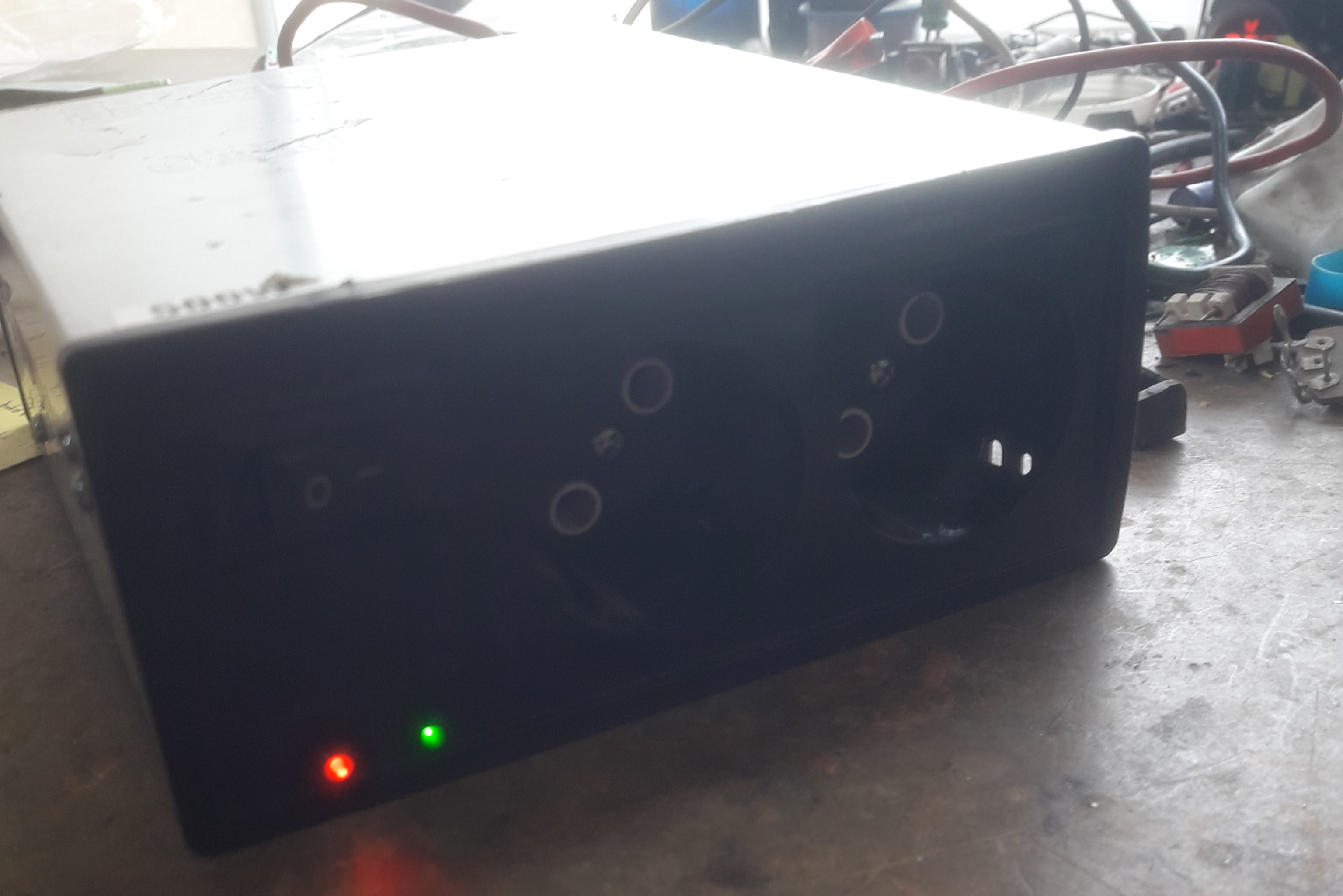

A customer brought a 500w dc/ac inverter and when I turn it on, the red error light stays on...

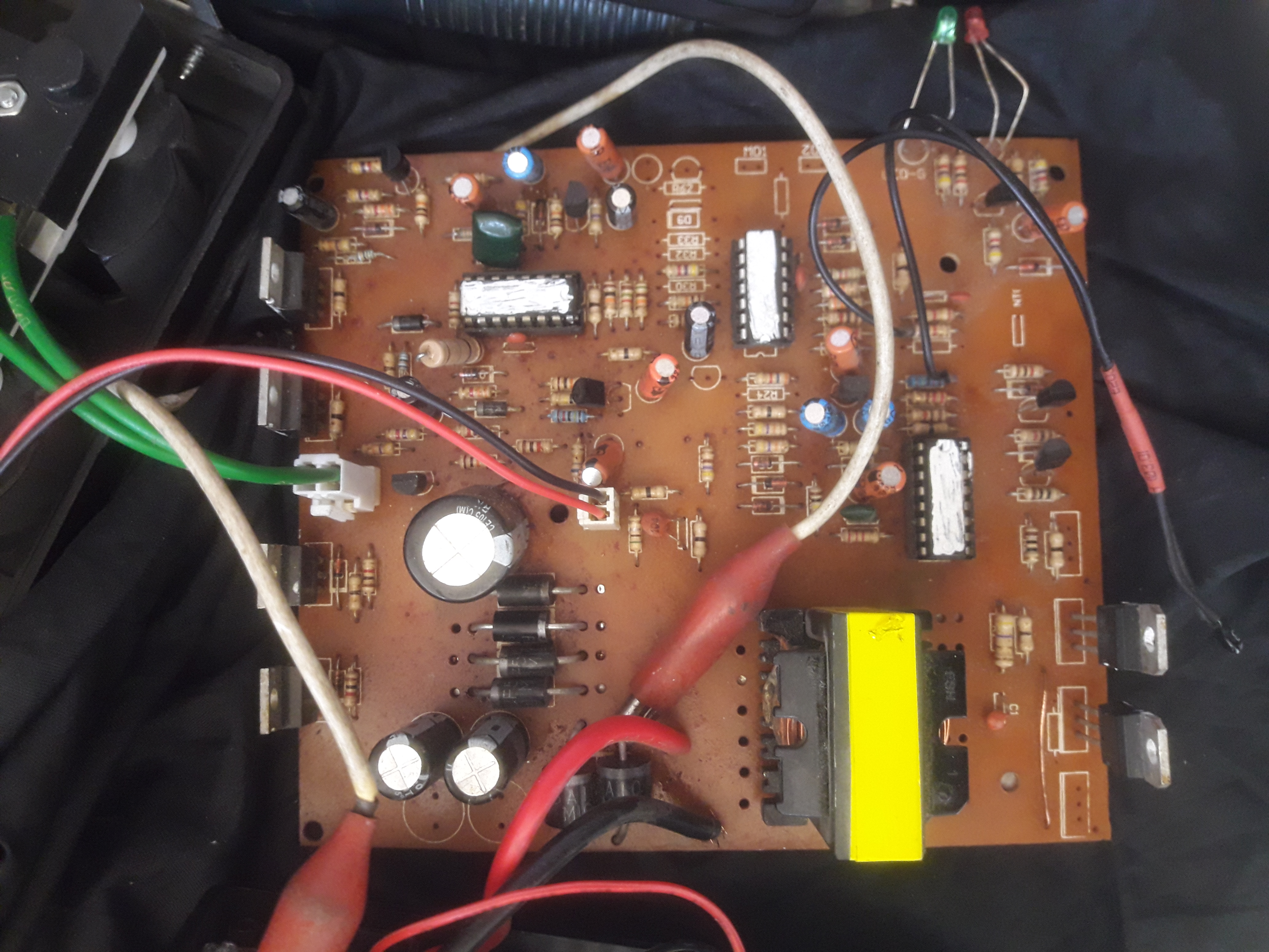

Operations performed:
It is in the following order
1 Testing and checking the input and output MOSFETs that are Healthy
2 Testing and checking all types of pulse and buffer transistors that are Healthy
3 Testing and checking all types of zener and signal diodes that are Healthy
4 Testing and checking all types of oscillator capacitors
5 testing and checking ICs, except for the top one, I don't know what the part number is
Unfortunately, I don't have a scope, but I do have a multimeter
I don't know what the upper IC is, but I found out by routing by pcb, but the ground is connected to pin 9 and 10

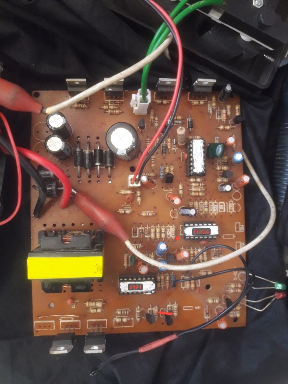

I would like to serve you with this part number. These three ICs were worn together. I found two of them by analyzing the bases according to experience. For the part number tl494 and lm324, only the upper IC remains. I don't know what it is, but the code is inserted under the ICs.
Lower IC 26N4
Ic in the middle of E49
Upper IC 26R1
guys and have a good time...
To colleagues and professors
With total precision and sensitivity towards repairing the board and the device, it was fixed by routing and measuring the voltage from the low IC in pin 4. One of the resistors next to the ptc had a hairy cold solder, which could not be seen with the naked eye.
