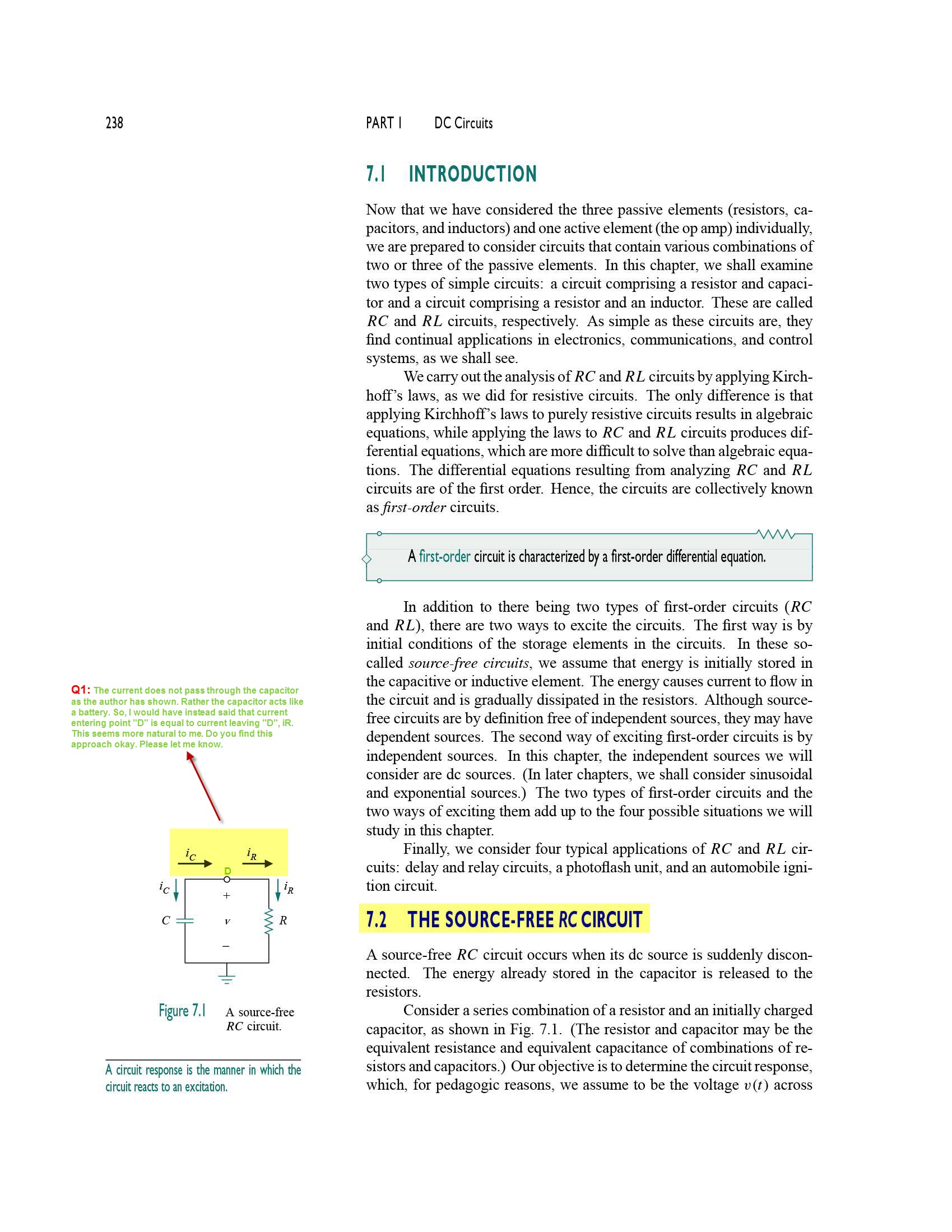

Hi
Please have a look on the attachments. You can find my questions there. Please help me with them. Thank you.
Regards
PG

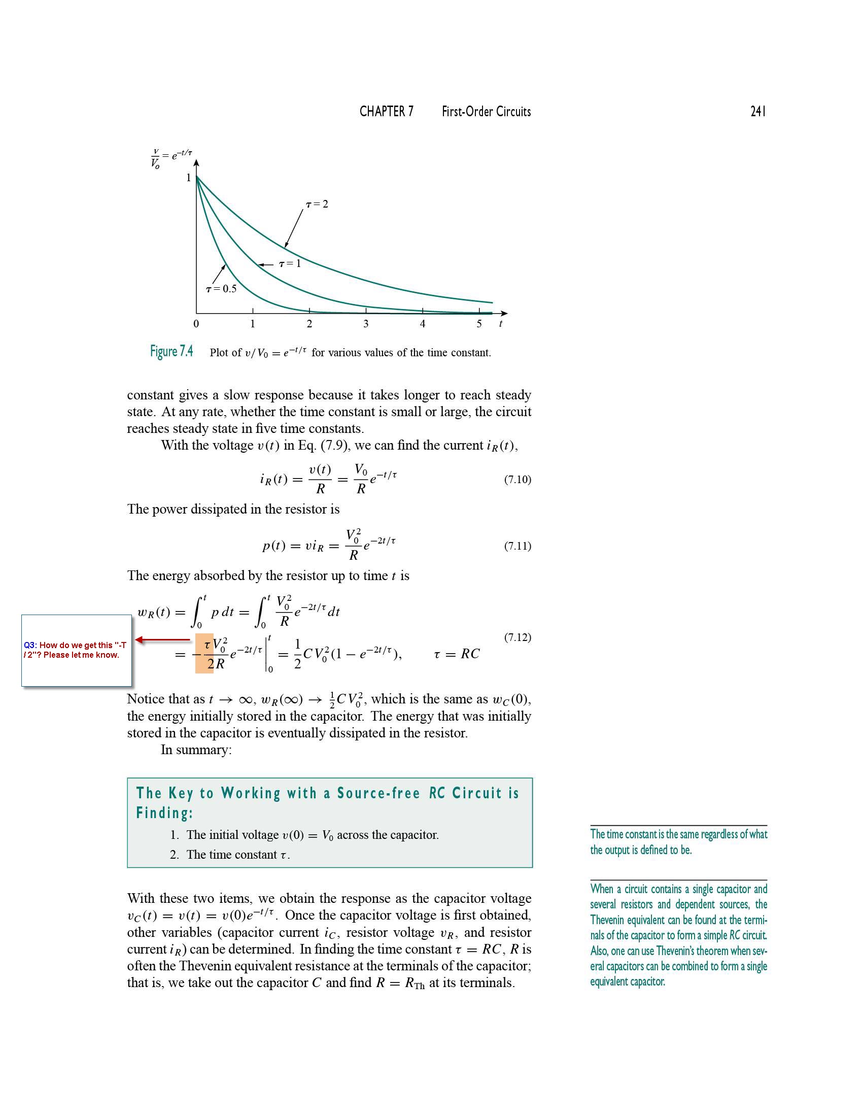

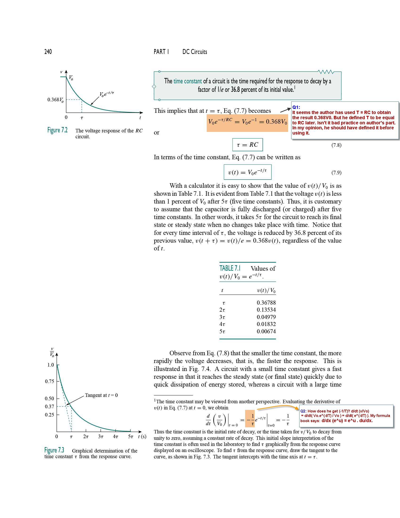

Hi
Please have a look on the attachments, you can find my questions there. These two pages follow directly the attached pages in my first post above. Please help me with the queries. Thanks a lot.
Regards
PG
PS: Please excuse Q2.
