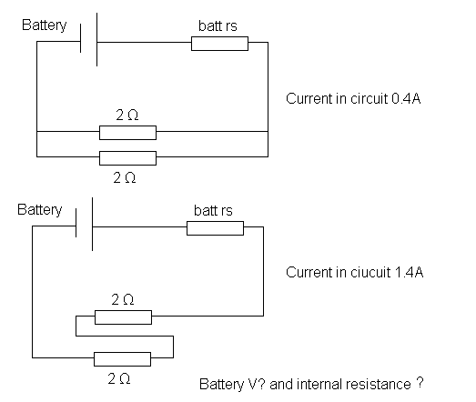

in a circuit two resistors each of 2 Ω is connected in parallel to a cell such that a current of 1.2 Amps flows through it now when those same two resistors are connected in series a current of 0.4 Amps is detected in the ammeter.(taking resistance of wire as zero)calculate
1)internal resistance of cell
2)EMF of cell
GOOD LUCK:)!!!!!!

I suspect there are different understandings of the English -- subject verb agreement and such. This is how I understood the description:
R3=battery internal resistance. The current is current through the battery. How about posting your answer hidden as spoiler? Since ammeter resistance wasn't mentioned, I assumed one was not in the circuit. That is, it was a Hall or similar type ammeter.

R is the internal resistance of the cell. V is the cell EMF
1.2 = V/(R+1) so V = 1.2(R+1)
0.4 = V/R+4) so V = 0.4(R+4)
So 1.2(R+1) = 0.4(R+4)
1.2R + 1.2 = 0.4R +1.6
1.2R - 0.4R = 1.6 - 1.2
0.8R = 0.4
R = 0.4/0.8
R = 0.5
V = 1.2R +1.2 = 0.6 + 1.2
V = 1.8

Same as you ( even though the question was written down wrong ) For 1.4A and 0.4A it was correct!!
Les Jones My solution was very similar to yours. I just wrote the equations for each case, equated them, and solved for one variable. Then substituted to get the other variable.
