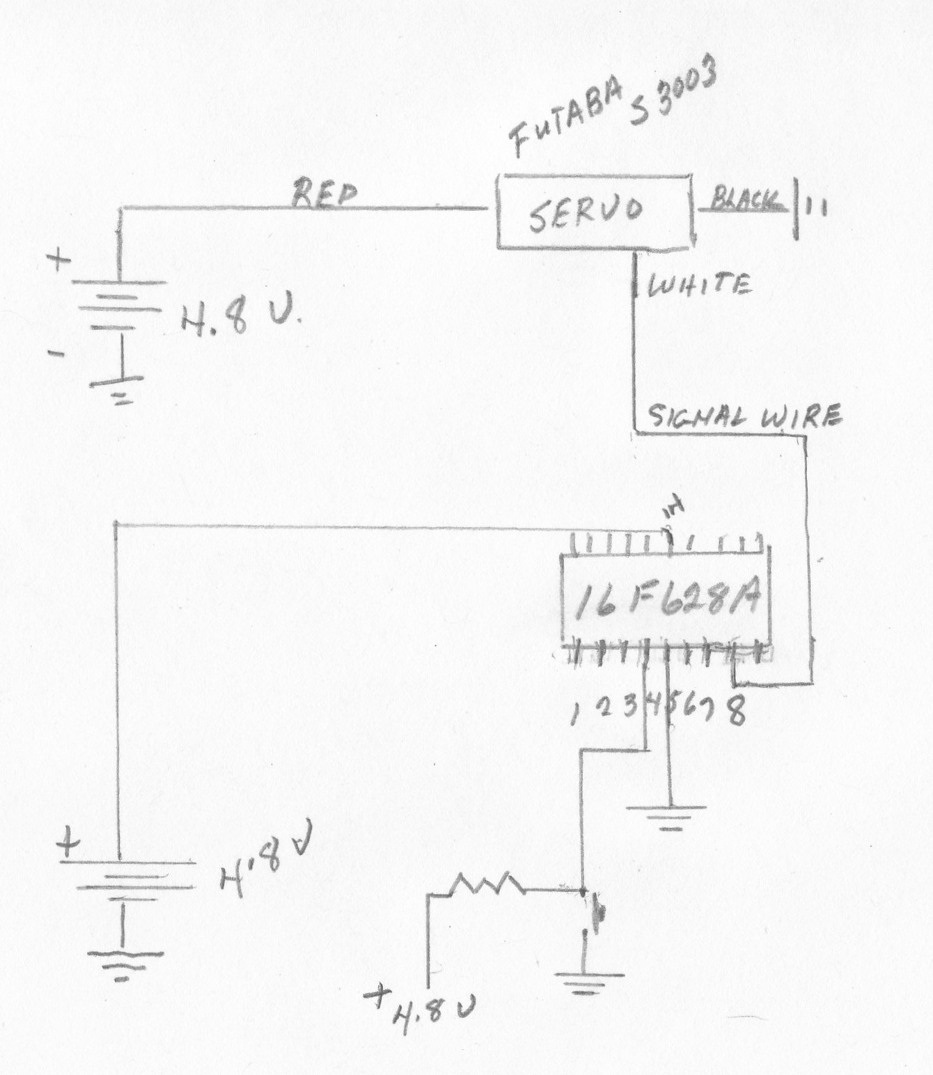

Looking for a little help. I want to control a servo moving it 180 degrees clockwise and back 180 degrees counterclockwise using a 16F628A Pic. At present when I power the pic the servo only rotates clockwise to the end. My knowledge of pics is very limited so I can use all the help I can get. I have attached a hand drawn schematic of the circuit that I am having a problem with, and the .asm code that I am using. Thanks for any help that I may receive.
Most servo's can rotate to that degree, standard servo signals are generally timed around 90 degrees each direction and the POT used in typical servo's can at best provide 120 degrees.
Your 'Backward' routine will never end because you initialise 'Count' at the beginning of every loop. Put the first 2 instructions in 'Backward' at the end of your 'Forward' routine.
Verify that you are actually getting output on your pins. Have you tried to light an LED to make sure the micro is initialising and running properly?

Hi Jon. Still no go. I checked the voltage at RB2 and it only reads 10 mv. Should this voltage not be around 5v? Both battery voltages are 5.2 V. I have placed the momentary switch between RB0/INT and vss with no resistor and it also has no effect when I activate it. Sometimes when I make the battery connection to the pic the servo will move slightly clockwise and then other times it does not move at all. Thanks again for all the work that you have gone through to help me get this thing going.
OK I just made some more corrections to the above code. Re-copy and paste it, then assemble and try it again.
pic to servo
Still a no go Jon. I am getting 10mv at the output pin RB2. Not enough to even light a LED which I tried.
OK...before I look at the code, can you measure the voltage on RB0 and tell me what it is?
Also, do you have a pull up resistor on RA5?
pic to servo
No, I did not have a resistor connected to RA5. The voltage at RB0 is minimal, around 5mv. However I did connect a 10k ohm resistor to RA5 and now when I push the reset button the servo will move a very short distance clockwise and stop, then when I push the reset button again the servo moves a very short distance counter clockwise and stops.
That would be your issue right there. RA5/MCLR is currently functioning as MCLR. Without referencing RA5 to Vdd either via a pull up resistor or a direct connection to Vdd, this leaves MCLR undefined, so the PIC doesn't know whether to run or reset itself. It's probably stuck in reset.
RA5/MCLR is input only. It CANNOT be set high in code. It MUST be driven high externally via hardware.
Do either one of these 3 things -
1) Place a pull up resistor between RA5/MCLR and Vdd
2) Connect it to Vdd directly or
3) Add _MCLRE_OFF to the configuration word
Retest and see what she does.
OK Jon, I connected a 10K ohm resistor to RA5 to vdd. The servo now moves a very few degrees clockwise when I push the reset button and then stops. When I push the button again the servo moves counter clockwise and stops. It just keeps moving back and forth a few degrees with each push of the button. The way I would like the servo to work is to have it move in both directions with just one push of the button.
