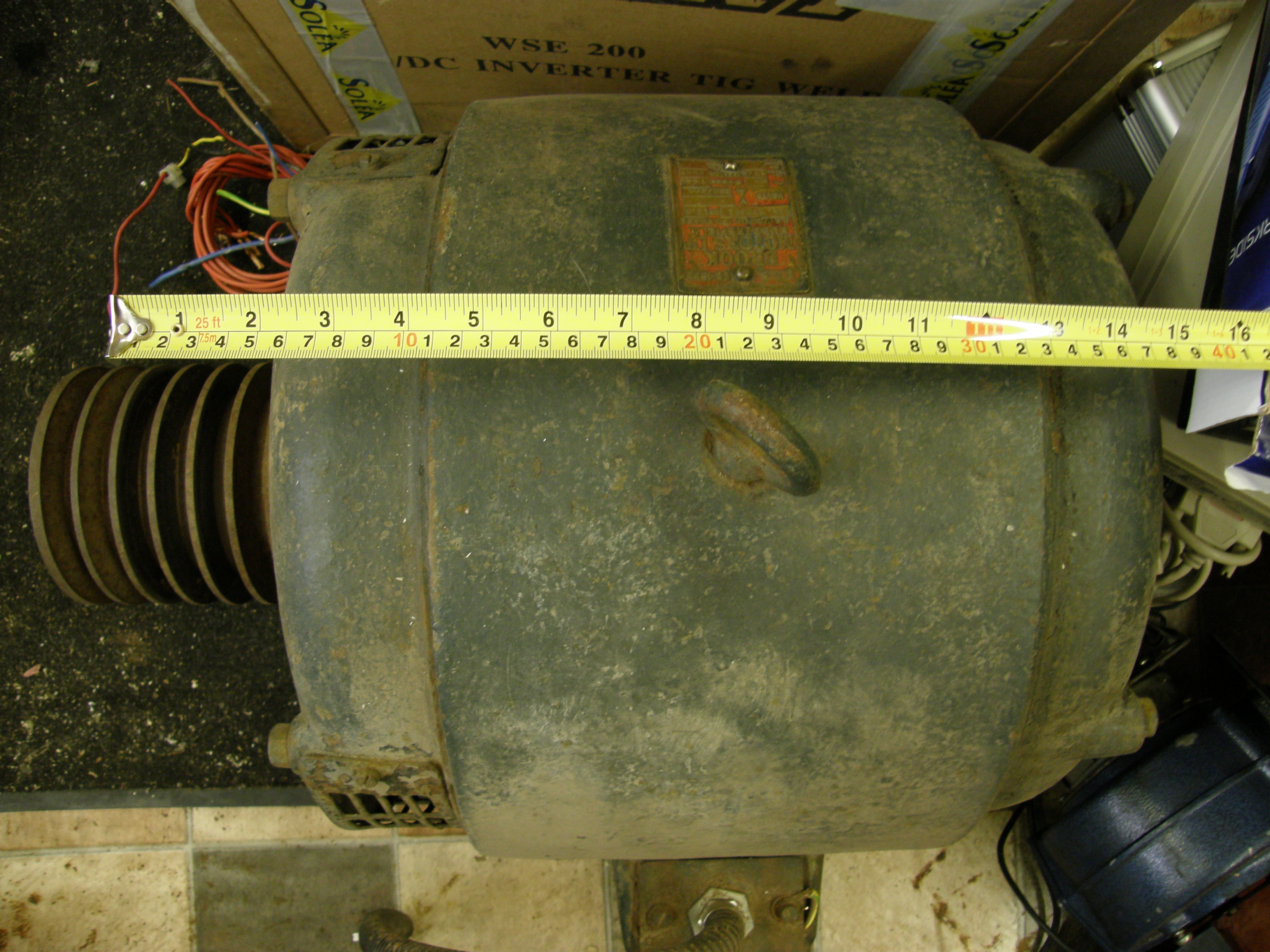

I took a chance about 1 month ago and bought a very old 12.5hp Brookes motor.....it is one big heavy mother of a motor.....solid cast iron frame....it took 4 men to lift it out of the rear of my mpv.....with nipped fingers and holding backs all round! It has 6 wire connection (marked only for Delta 380/400V, 17.5amps, 1440rpm).....so I'm guessing it would originally have been started using a mechanical Star/Delta switchbox (to save neighbours complaining about dipping lights/supplies upon startup!) ...... it came off an old massive cast-iron bench circular wood saw that another guy bought to convert to be driven from a tractor PTO shaft.

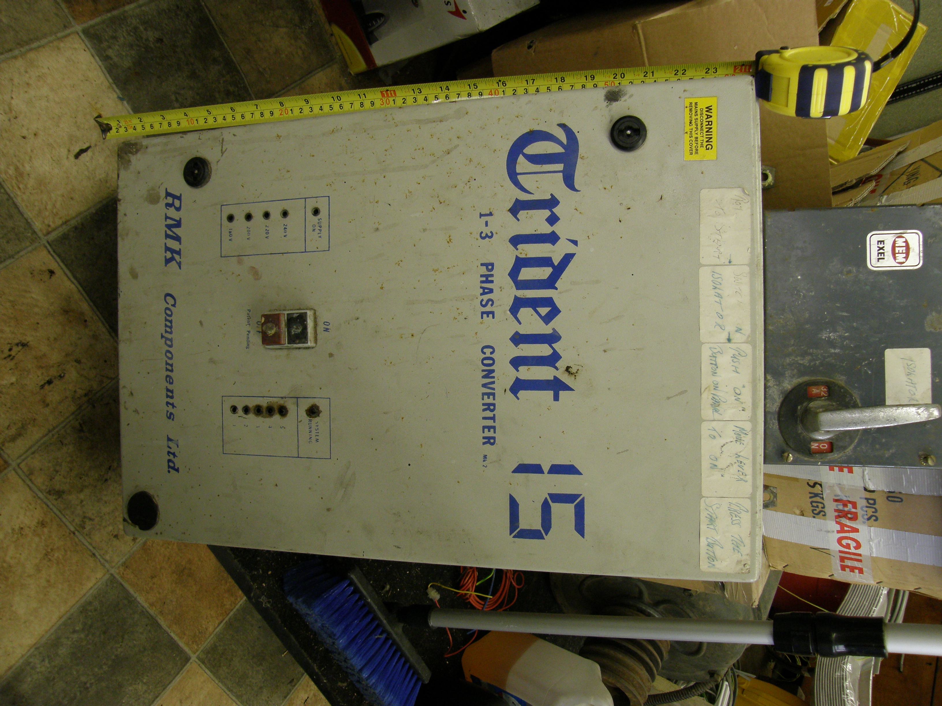

See attachments for some pics of converter box in stripped down, original dirty state, condition.

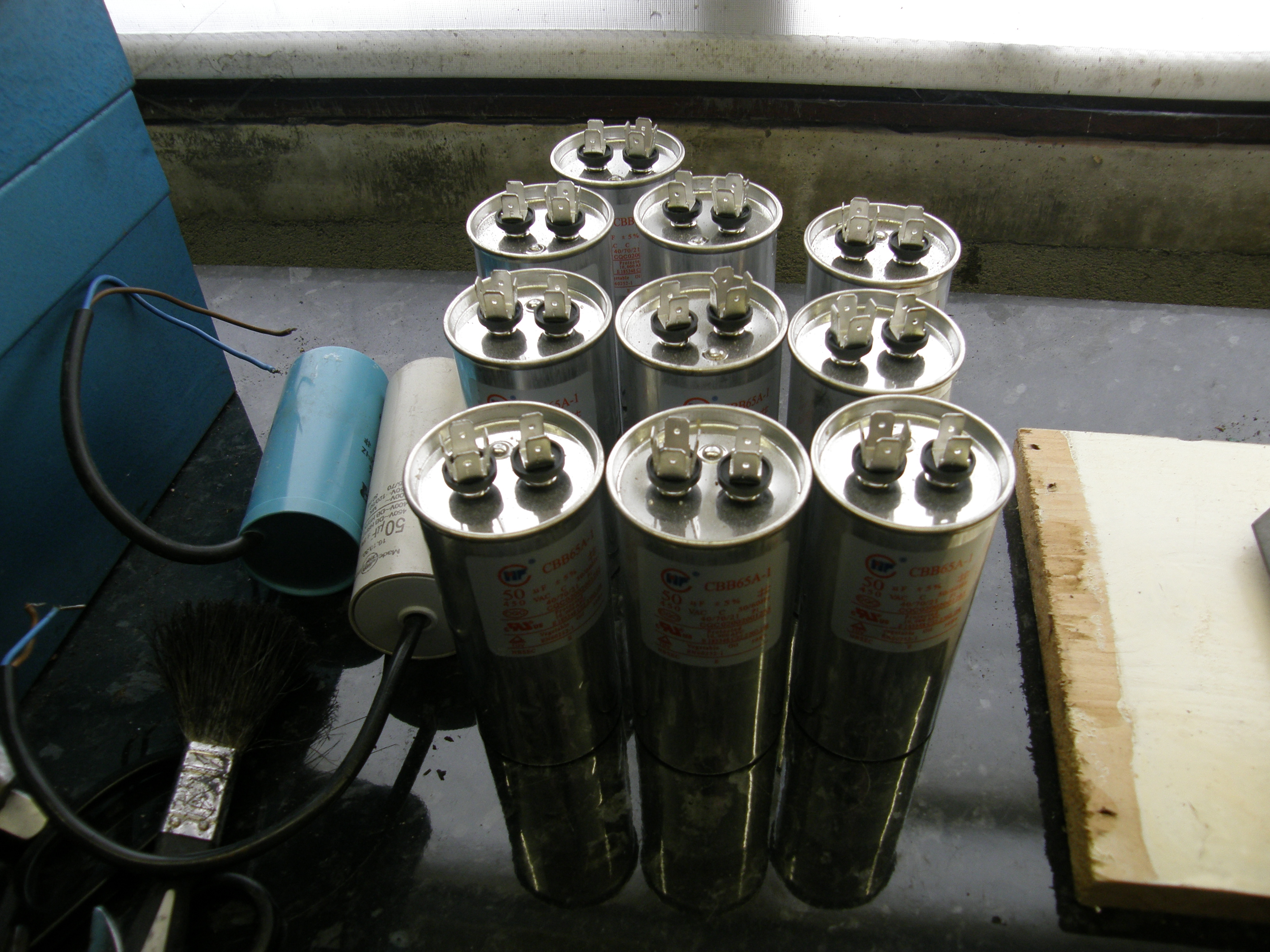

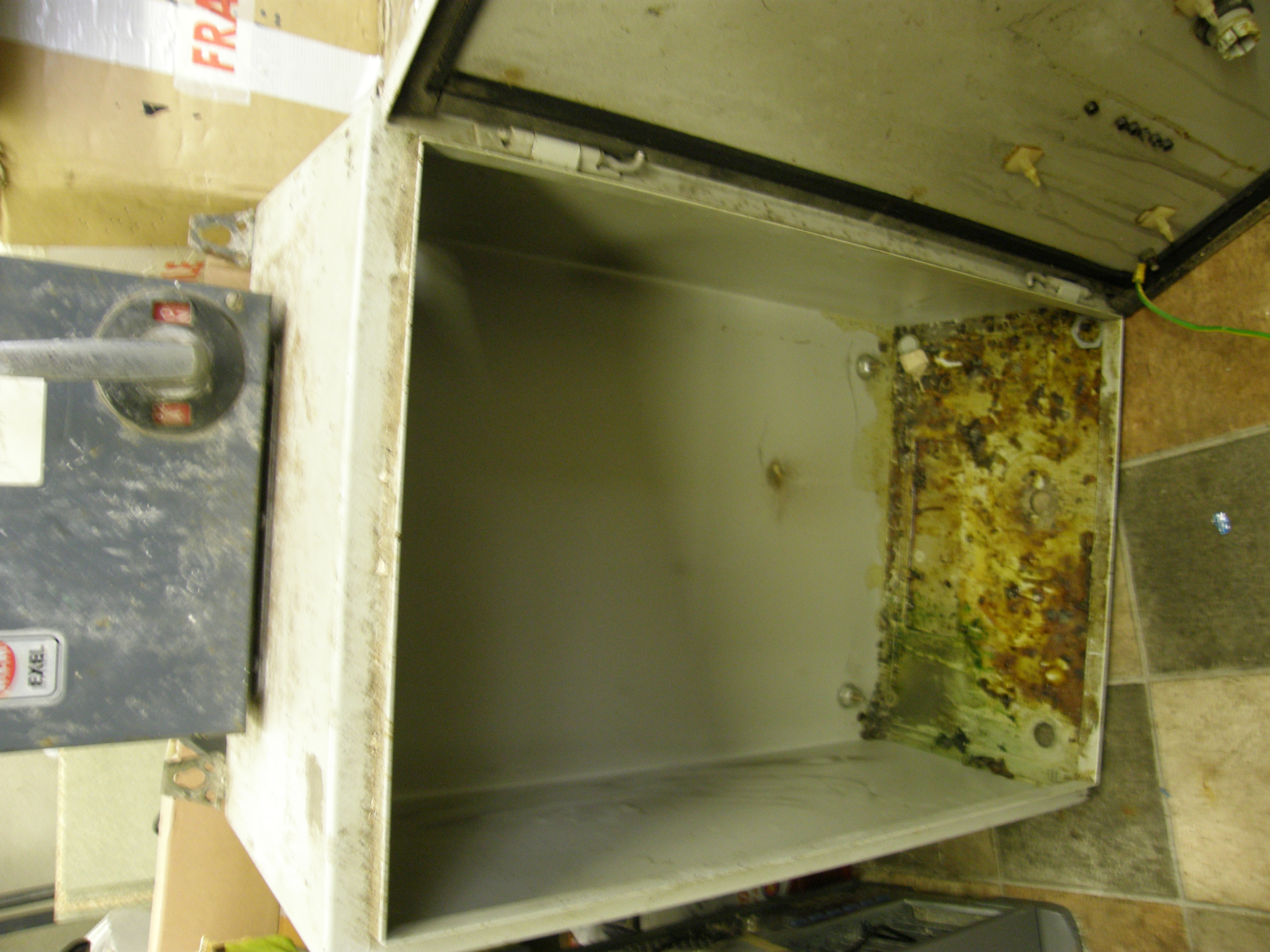

As you may see from the bottom of the empty box, a few caps had reached their sell by date and leaked their vegetable oil guts, plus there was one wire from the cap bank that had chaffed thru on sharp edged metal frame probably also adding to their demise. These will all be replaced with new ones I have obtained from China.

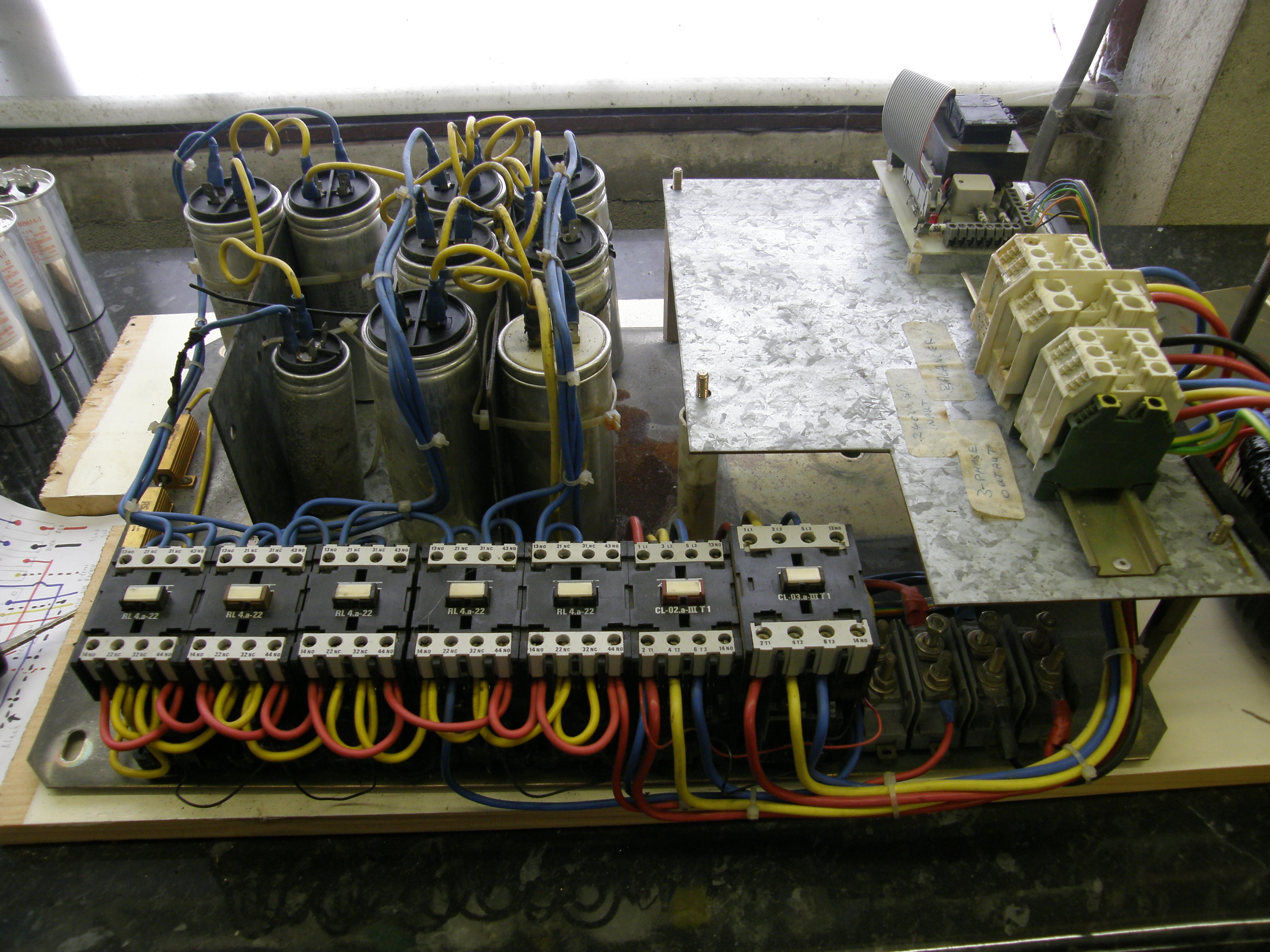

Two sides of two of the contactors were reading high resistance, but I was able to switch over unused contacts on two of the other contactors to cheaply cure this problem...... again, the old gear lends itself to be easily disassembled / repaired!

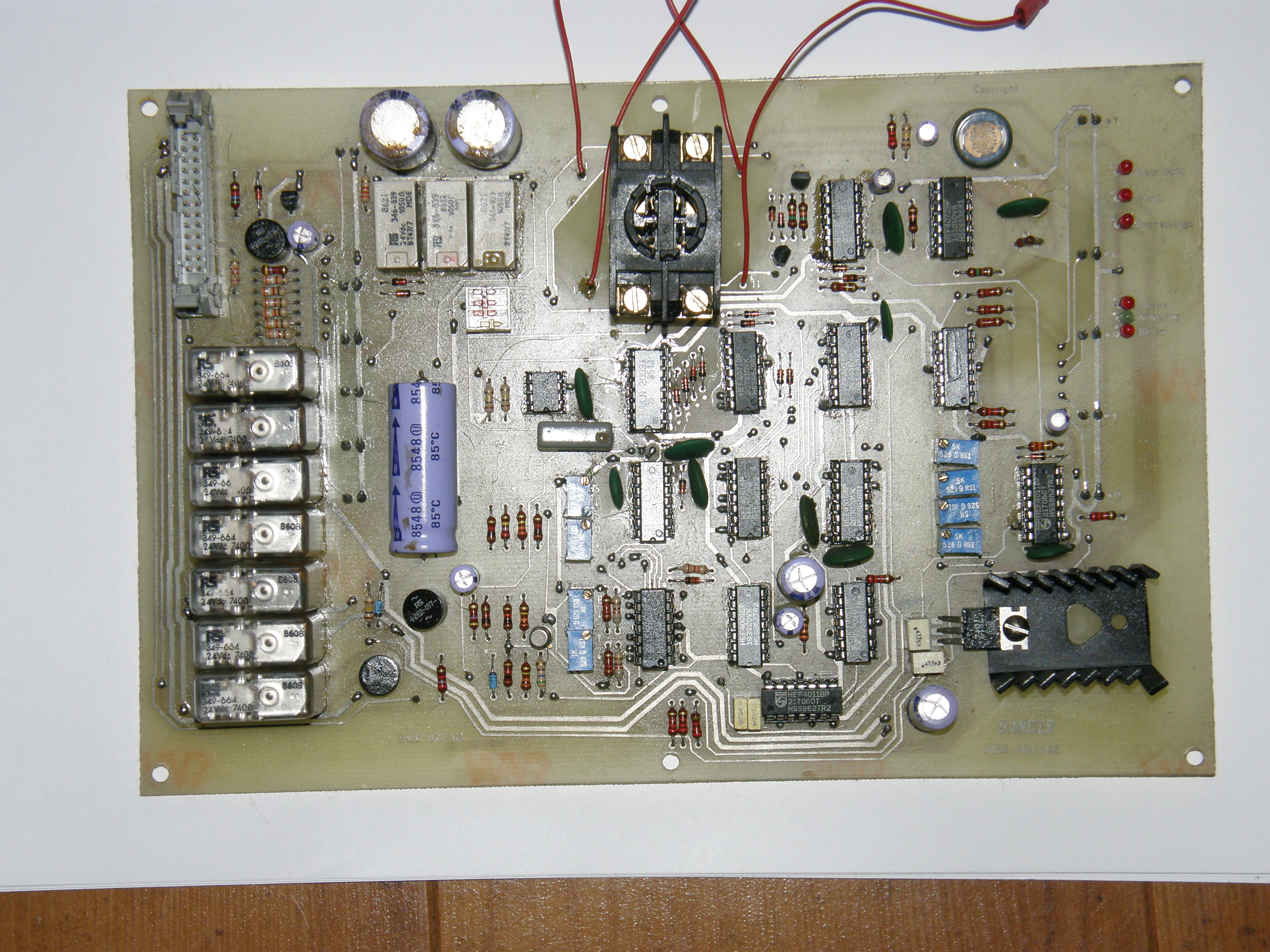

As you can see, I've traced out the main heavy wiring from all the contactors ..... the control pcb with multiple chips and double side print will certainly take longer to achieve a usable schematic from...... a pain in the butt to do, but not impossible, since there's no surface mount electronics to drive you raving mad whilst loosing you eyesight!.
