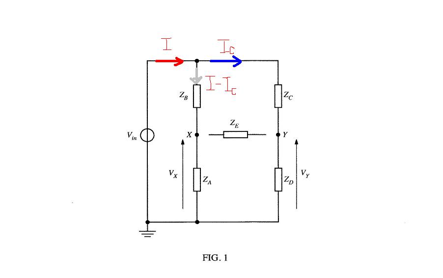

Hi I have the following question (please see attached). Any help would be much appreciated as I have searched through all the text books I have and couldn't find any similar problems...

A clue would be that the voltage at the ends of Ze would have to be the same.
Another Clue:
What does "zero current" have as an equivalence: "Short Circuit" or "Open Circuit" ?
You can re-draw your schematic with the corresponding equivalence to "see" the solution more clearly.
If you have zero current and it's really zero between two nodes than you can open the two nodes and you'll still have zero current.
Thanks for the suggestions, does the direction of the arrows have any significance?
The arrows in that diagram are just to indicate the voltage reference points, ie: the bottom line of your circuit is the ref and the two voltages are measured from that ref point.
Have you solved the problem.?
No I'm afraid I still haven't solved it yet! ZE has an open circuit equivalence but should I use node or mesh analysis? And what is meant by the 'condition'? Will the final answer just be Vx = Vy expressed in other terms?...I need help please!

So, Vx=Vy means the current in ZE is null. You disconnect it to see more clearly.
Look at the picture I attached.
You are given something, and then tinker with the equations a little bit..
If Vx=Vy , it is then safe to assume that the difference of potential between ZB is equal to that one between ZC.
What does this mean ? Write down the equations in terms of currents. (The currents are I and (I-Ic) )
So, we've got VZA=VZD (1)
VZB=VZC (2)
Write each one in function of the current circulating through each one (example: I-Ic circulates through ZB and ZA so... ? )
You will have two equations on the form X*k=Y*j (1)
W*k=Z*j (2)
The next step to tinker with it would be of course to divide one by the other and get rid of k and j so you only get X/W=Y/Z (And this is equal to (X+Y)/(W+Z) too, we must not forget primary school :D )

Thanks Jugurtha! so is the final answer: (Zb + Za)/(Zc + Zd) ?
When they ask you about the conditions to get a null current through ZE, something like (Zb+Za)/(Zc+Zd) doesn't mean anything .. It's not an equation or something ..
You got asked what are the conditions to get a null current through ZE, you START from this, from what you have been asked and take it as granted, as your starting point, then you "follow" the consequences of a null current through ZE which are:
*ZA and ZB are juiced by the same current.
*ZC and ZD are juiced by the same current.
VY=VZD=VX=VZA
VIN=VX+VZB=VY+VZC , with VX = VY, so they cancel each other we'll have:
VZB=VZC
What does this mean, we write that in currents going through them:
VZB=ZB*(I-Ic)
VZC=ZC*Ic
VZB=VZC ==> ZB(I-Ic)=ZC*Ic .... (1)
VX=VY , written another way ZA(I-Ic)=ZD*Ic ..... (2)
We divide (1) by (2) to get rid of currents to find the CONDITION to have a NULL current on ZE.
So (1)/(2) gives : ZB/ZA=ZC/ZD=(ZB+ZC)/(ZA+ZD) or written in another way, ZB*ZD=ZC*ZA.
That's the condition one the impedances ZA, ZB, ZC and ZD to get a null current on ZE.
So in your circuit, if you chose for example ZB=10 ohms, ZD=2 ohms, ZC=1 ohms, ZA=20 ohms, you'll get a null current on ZE.
Have a look on Wheatstone bridge, but no matter what, in this kind of problems, you are given a constraint, and you kind of "backward" engineer or reverse stuff to get to *satisfy* this constraint.
