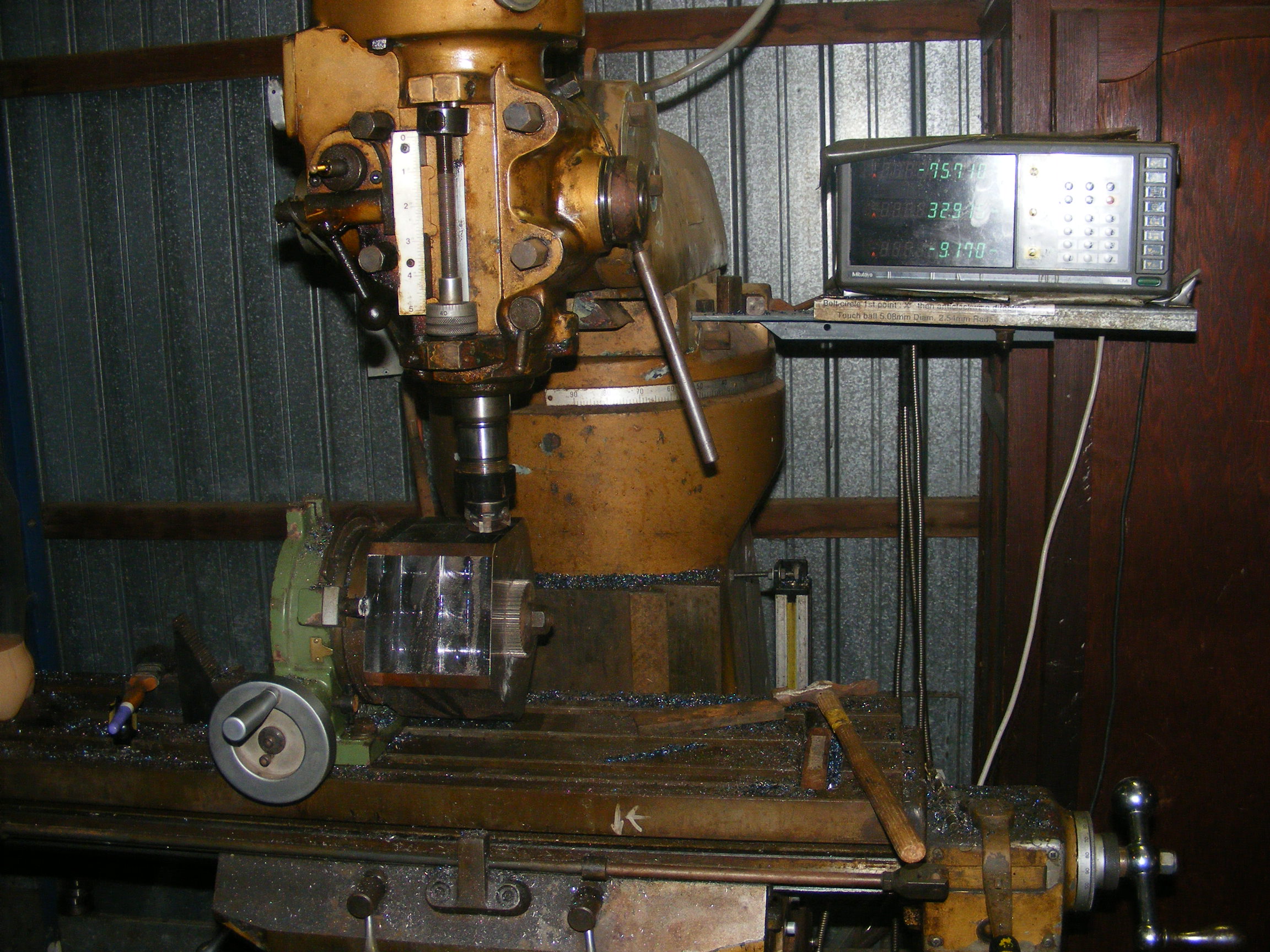

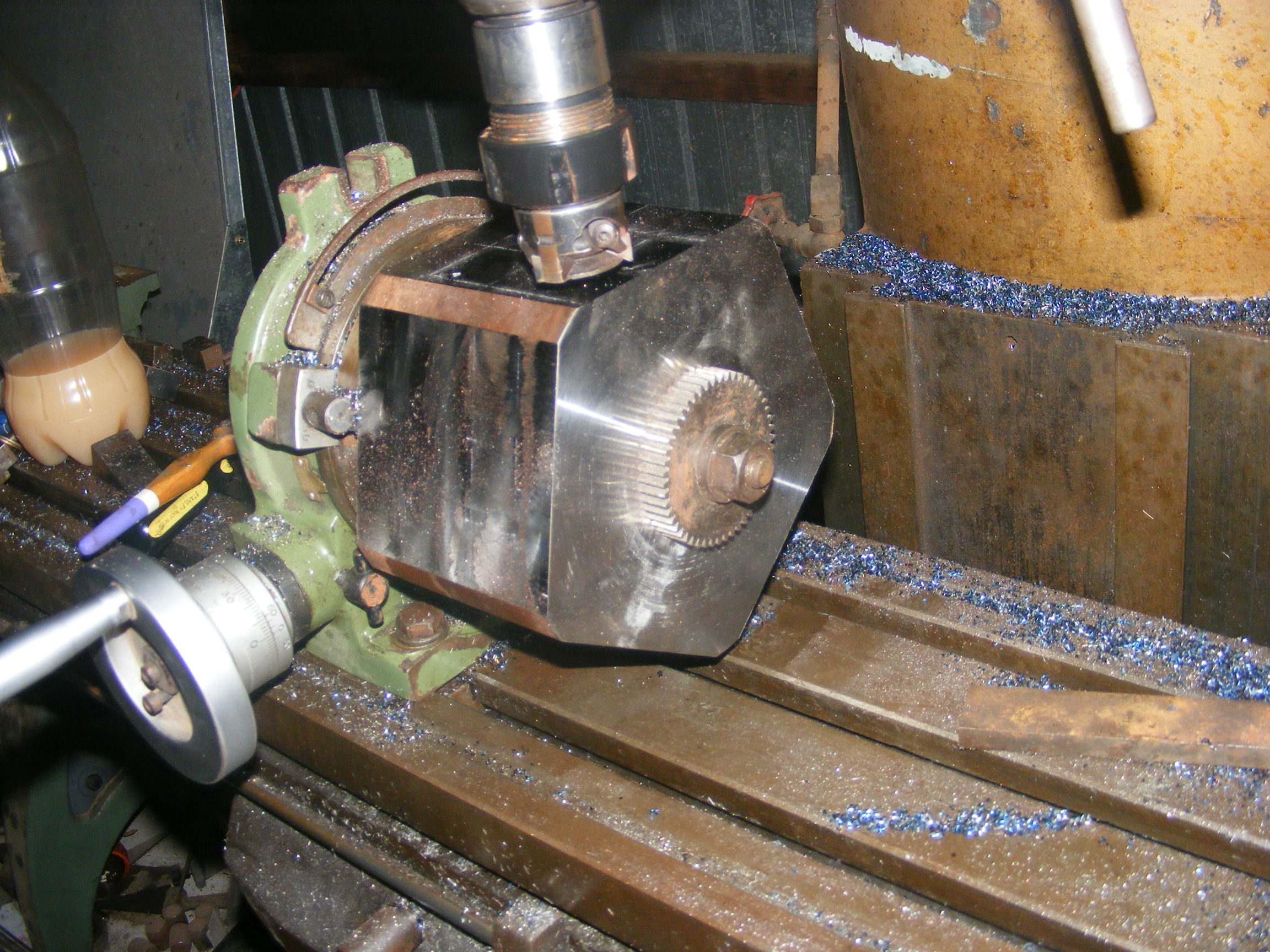

As one can see with a few mod's to the head arrangement this style of engine would be a smooth runner. I had a steel billet at work rusting away that measured 177.8 diameter and when faced 110mm long. Today being xmas day and with the sun shining I spend about 6 hours on the mill roughing down the crankcase. With the material being EN35A it is pretty tough on tools and only small cuts could taken. Anyway got a 5 sides roughed down and in the morning I'll put up a facing tool and do the final cuts ensuring all 5 sides are within 0.001". for the barrels I do have a few old engine crane rams which will be purfect for the barrels. I'll bore a seat on each face and put a O-ring groove on the seat and use 4 off M10 tie rods to clamp the head and barrel for a air tight seal. For the pistons I'll make my own and use some chrome leather soaked with silicon grease for the piston rings.
