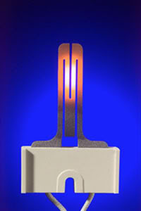

I am thinking of using a hot surface igniter that would also be used for flame rectification sensing.

Here is what a commercial hot surface igniter looks like. It is big and heats up to 2000 deg fahrenheit.
Model glow plugs glow yellow-red. They may ignite propane at normal pressure, but I am not sure. My other concern would be longevity. In a model, they can be relatively short lived (several hours). They are kept hot as a result of catalyzing oxidation of methanol. With so-called "gas-glow" fuel (a mixture of methanol, oil, and gasoline) they provide ignition after removal of the battery. Again, the methanol keeps them hot. They will not ignite pure gasoline-oil mixtures after removal of the battery. Moreover, pure hydrocarbon fuels burn hotter than methanol fuels.
Thus, it is hard to assess their longevity in a situation where they would be exposed to a continuous propane flame. My guess is that a hot-bar ignitor, as you illustrate, would last longer. However, if longevity is not an issue, then model glow plugs may be a cost-effective alternative.

Speaking of longevity, I am now reading that the ceramic (silicon carbide) hot surface igniters can be damaged by water, this is not good either.
The newer silicon nitride igniters are more robust and less affected by moisture but don't know if they can still be damaged by rain.
