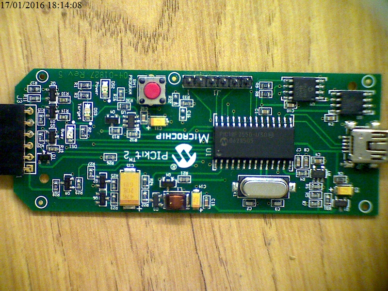

I have had the firmware in a PICkit2 become corrupt and it was not seen by the PC. I re loaded the firmware and it has worked perfectly since then. (Several years ago.) There are 6 holes in the board marked J1 These are the ISCP programming pins. This is a picture with pins soldered into these holes.
This is only of use if you have access to another working programmer. The firmware file to load is PK2V021000.hex

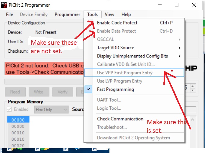

I don't know but I do know this the pickit 2 can reprogram chips that have been set wrong with the configure bits
I don't have the pickit2 hooked up but it works I've programed all kinds of pic that had problem till I changed the VPP first setting that pulls up mclr to program voltage from the get go.
I tried you suggestion and it works, thank you.

secondly there is one situation where funny observations are made.your Design has no crystal and uses internal oscillator . For optimal use of port pins, people use Internal MCLR and use the pin 4 (case of F628A) as a normal port pin.
At first when a new chip is programmed , things go well. Next time as the chip is powered by pickit2 it starts working with earlier program and won't allow you to re program.
Here is why the "Vpp first facility comes into picture. If the OP is suffering from similar situation, perhaps he can configure the pickit2 accordingly and he could overcome the situation.
