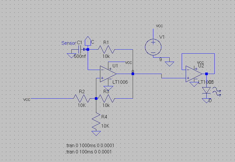

I prefer to use the opamp because I would have stable oscillations.
I found some single supply voltage opamps, like LM386 and LT1006.
Find the attached circuit.
Now, the problem is this.
If the object is near the sensor, the capacitance will increase, maybe to some % of farad, and the frequency of the oscillator will decrease toward a a dc value. If the object i far, in theory the capacitance should be 0. As the object disappear the frequency will increase.
At the limit, it should be infinity, but I think that a dc value will appear.
So, in order to detect the object, I thnik to add a counter of pulses.
Is it good?

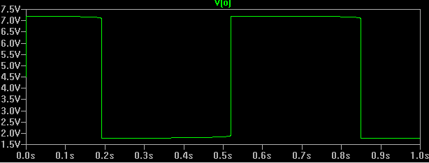

I did this circuit(in simulation).
But I really do not understand why the output is not 0-9v and instead it is 1.8-7.5 range.
I forgot something?
Any reply appreciated
G

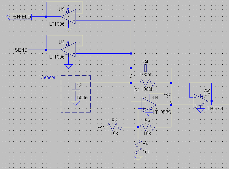

I guess the real queston is why you need it to go rail to rail. What's wrong with what you have, at least as a start. You could then focus on the rest of the circuit and come back to the oscillator, if you like the results from the capaciflector. I would also sugggest reconsidering the logic-based oscillator at 12V, single supply. John
Final
I will build the following circuit, which seems to work (in simulation)
Goodluck (to me)

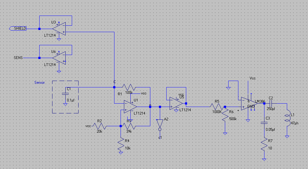

Because I would build also a PIC which accepts the oscillator output, but this circuit for a second step. PIC accepts TTL logic values, 0/5V.
Ok, I'll do it.
The truth is that my local store does not have all the components too!
Anyway, I'am near the prototype. One more thing.
The frequency of the oscillator increases as the object disappear, and decreases as the object is approaching. since I would test the circuit by my ear (see the LM386 in the previous circuit) I was wondering if there is a technique to "convert" the frequency.
I was thinking to a VCO...
giusepped said:
Ok, I'll do it.
I am not sure how a voltage controlled oscillator (VCO) would help you. What you describe is a frequency to voltage converter. Search on "tachometer". For example, see: https://pdf1.alldatasheet.com/datasheet-pdf/view/103466/NSC/LM2917N-8.html
A simple oscilloscope or a multimeter with frquency display will help you. Although, for proof of concept, the your ear is pretty good at discriminating tones. John
Edit: A simple low-pass filter with passive components may work. See: Horowitz and Hill, 2nd edition, page 618. There are other circuits based on op-amps (ibid, Chapter 9, regarding digital to analog conversion).

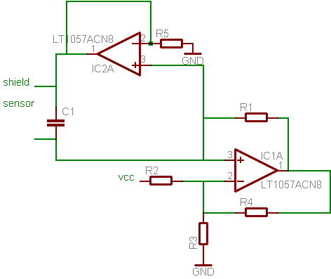

Got working
I made the following circuit and it seems to oscillate.
But I don't understand why.
Moreover, the capaciflector must be circular. I used two shapes, one was a rectangular shape and the second one is circular.
With the rectangular shape, nothing happens at the oscilloscope.
With the circular shape, I can appreciate some 1KHz variations in the rectangular waveform.
Somebody can explain to me why the circuit oscillate?
I know that this is relaxation oscillator, but the capacitance of the sensor is very high and in theory it should not oscillate. I am missing something?
