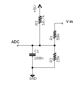

Sorry!!!! I have just gone back to my post!!!!
I have uploaded the wrong circuit!!!! The one I'm testing is this one..
Hi there Ian,
That looks like it has the optimum values for an input of plus and minus 15 volts and power supply reference of 5 volts, and ADC input range of 0 to 5v. Looks very good to me :)

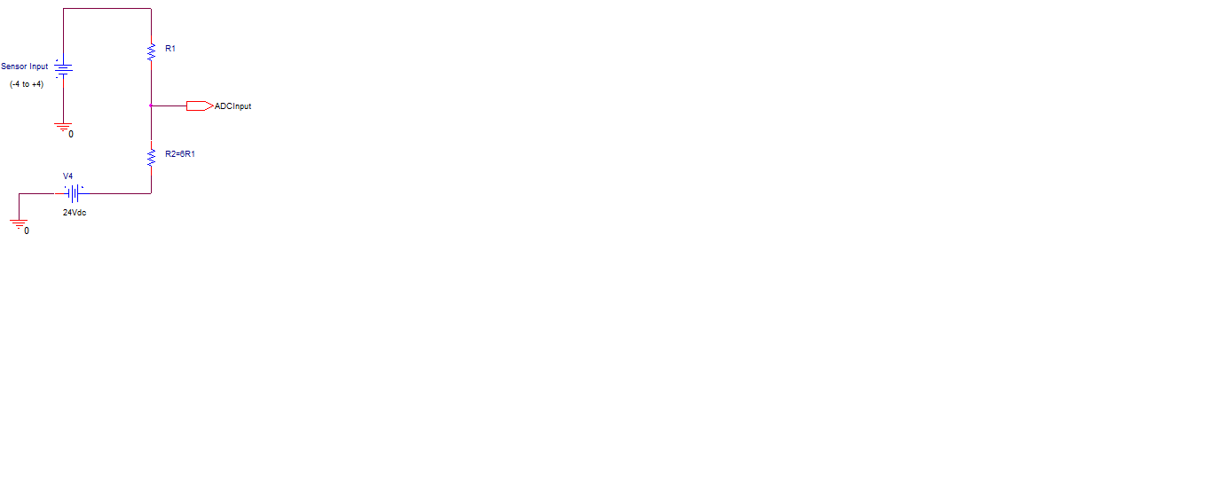

Thank you all for all the help. There is one mistake from my end the external supply is 24v instead of 5v which i came to know today only.
I used the equations suggested, but i could not fit it in as i was getting the negative values for resistor. I have drawn a voltage divider schematic by fitting the lowest range of -4 to 0v but the upper limit of 4v goes to some 7V (another existing resistor divider circuit in the board reduces this 7v to around 4.5V). Sorry for the mistake but could you please provide a new circuit or can I go ahead with the attached one. I am planning to test with the actual hardware an expensive one, so requesting your inputs to avoid damage to hardware.

For an input of -4v to +4v with a power supply of 24v exactly, the resistor values come out to:
R2=6*R1
R3=R1*30/13
but note that your schematic has no "R3". You need to add R3 to make this work right. R3 goes from the ADC input node to ground.

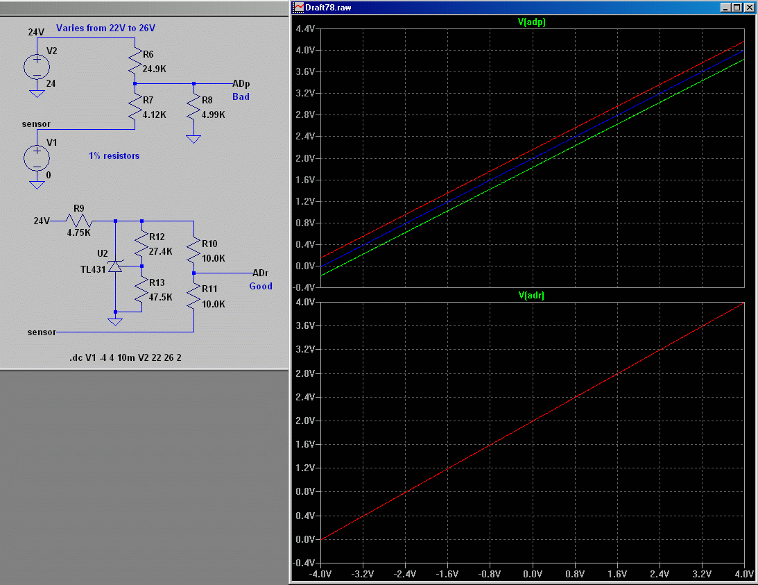

For this example the power supply variation will still affect the measurement, but it is reduced by a factor of about 3 because R2 is about 3 times higher than R3. A voltage reference diode is always the best though.
Here is a way to do it with a passive network. I show what happens if the 24V supply varies from 22V to 26V. Green is 22V, Blue is 24V and Red is 26V.
The second network eliminates the variation from the 24V supply. All three traces land right on top of each other.
