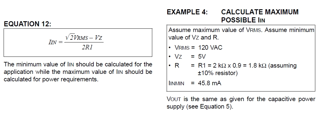

Ok im getting made here but at the equations used ...
Look at this equation... from ... AN954
eq-jpg.44732
This equation should be:
SQUARE ROOT OF (2*VRMS-VZ) / 2*R1
Correct?
If so then :
SQUARE ROOT OF (2*120-5) / 2*1800
then
SQUARE ROOT OF (235) / 3600
then
15.32970971675589 / 3600
then
why is my outcome 0.0042582526990989
4.25mA and not 45.8mA ???

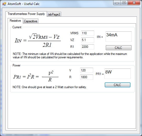

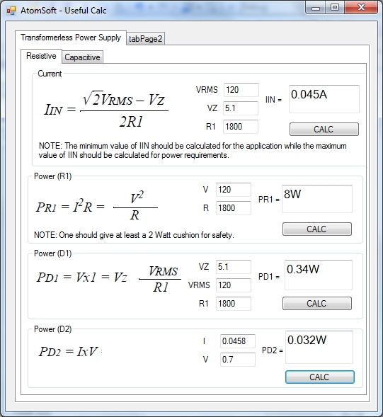

yeah.. i got that... Take a look at this.. Im making a calculator for this kind of stuff now to help others..
r1power-jpg.44752
Next ill add the calc for the Power and also the Capacitance version
