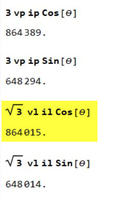

See the attachment where I get the same results using VL and IL or VP and IP.
On the other hand, I don't see why you are considering phase voltage V_p and line voltage V_l equal. Please see the highlighted part at the top. According to the text phase voltage and line voltage are different in balanced wye-delta connection.
OK, visualize a delta configuration. Put a voltage across one of the 3 impedances. Now, isn't the voltage across the impedance (VP) the same as the line voltage (VL)? Certainly the currents will be different by a factor of Sqrt(3), but the voltages are the same for a delta configuration. For a wye configuration, the phase voltage and line voltage will differ, but the current will be the same. Are you sure you interpreted the text correctly?
PS: Furthermore, "θ" in cos(θ) is the angle between voltage and current which means it should be cos(0-36.87). Although cos(-a)=cos(a), I just thought that I should mention it here because in case of reactive power, it would cause an error.
The power triangle follows the impedance triangle. Since the impedance has a positive angle, the reactive power should also. I should have known better. The attachment shows the same answer worked 3 different ways using Vl=VP and a positive angle.

Something is still confusing me. You wrote sqrt(3)*V_l*I_l*cos(-36.87)=sqrt(3)*4157*150*cos(-36.87)=864 kW. Why is so? When line current, I_l should lag corresponding phase current, I_AB, by 30°. In my humble opinion, I_l, should be 150∠-66.87°. Please check calculation on phase current and line current in part (a) here. Thank you.
It would help if you disclosed the post number where that occurred. Anyway, apparent
power does not care what the phase of the current is with respect to voltage. It is proportional to the square of the absolute value of current. Current phase does not enter into the apparent power calculations. Apparent power is V I*, where I* is the conjugate of I. Multiplying by I and dividing by I gives V I I*/I = V I^2/I = Z I^2 , where the phase of the current is not considered.

We are calculating real power, not apparent power so the phases of current and voltage do matter. I'm sorry if I'm missing something obvious. Thanks.
Once you have apparent power, you can easily calculate real power by multiplying by the cosine of the impedance triangle or reactive power by multiplying by the sine of the impedance triangle. In any case, apparent power does not care about the current phase in relation to the voltage or other current. The current phase angle vs. voltage might or might not match the impedance triangle angle depending on the configuration, but the impedance triangle is the gold standard for the power triangle. Neglecting that fact is what got me the wrong answer the first time I did the last problem.
