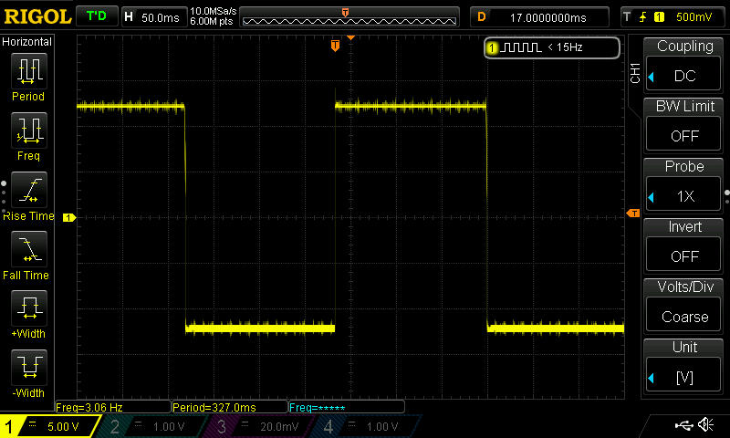

Downspikes of about -2V appear during MOSFET switch time on the rectifier output, no matter what value C2 (up 1.000uF) or R4 I tried. Is there any way to get rid of these spikes on the rectifier output?

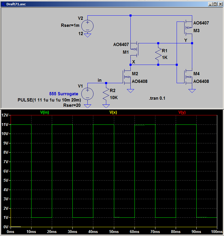

Here is the preliminary schematic. Part of interest is upper right.

Have you checked the shoot-thru current on the h-bridge. That is a very poor H-bridge circuit because with this very simplistic (naive) method of driving the gates there is a huge potential for having the upper and lower fet on each side of the bridge on at the same time.
Yes, has been checked: it actually is more of a problem of microsecond delay between shutting down one side and starting up the other side.

First, convince me that this is even an H-bridge. After the first edge from the 555, it never changes state again. It looks more like a latch to me.
It is a latch, but this was pointed out previously (in another thread) and he's added pull-up resistors to the drains of the two lower MOSFETs which solved the issue.

I'll bet that if he posts the real h-bridge schematic, and we simulate it, it will have shoot-through up the whazoo...

In my opinion the spikes are due to MOSFET switching delays, in effect creating very short moments of no conduction across the load. What puzzles me is that a cap across the rectifier output cannot smoothen these downward spikes.
...What puzzles me is that a cap across the rectifier output cannot smoothen these downward spikes.
Where is the scope probe ground clip? You have a floating load. If the scope chassis is grounded to the AC line, then the only way you could read the voltage across the filter capacitor is with a true-differential measurement.
What is strange is that when the rectifier output is high, hence the optocoupler is conducting and pin 5 is to ground, that spikes are measured at pin 5 of the optocoupler.

However, when the scope ground clip is connected to the circuit ground then there should be no issue: the power supply is not connected to ground, hence floating, and will follow the scope ground. No?
