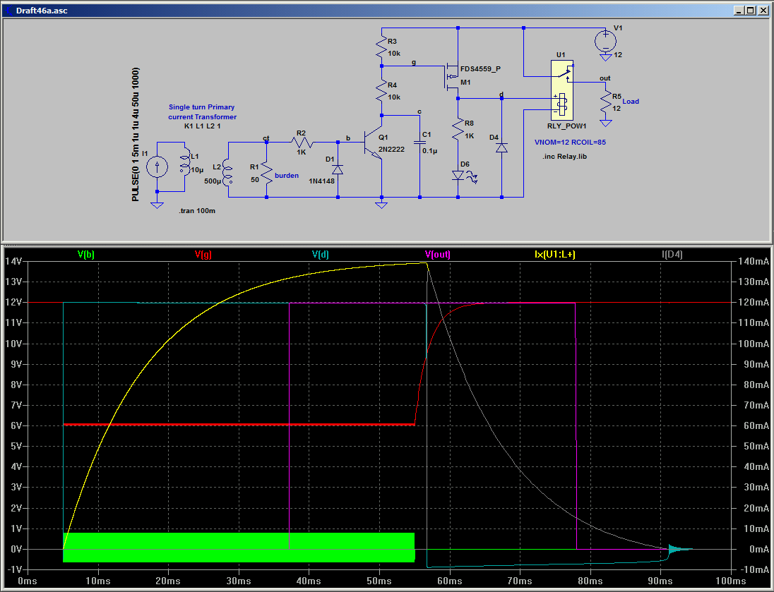

Here is my hack:
Input comes from 1A 10% PWM on one wire going through donut on CT. Sensitivity is adjusted by R1, the CT burden. I simplified the current limiting to the base of Q1. I played a bit with the time constant R3,R4 C1. M1 is almost any modern PFET. The relay is the standard automotive sugar-cube like made by Bosch. D6 is a LED. D4 is any Si rectifier used as a snubber.
Note the time constants, especially due to the inductance of the relay coil (see the yellow trace).

Here is my hack:
This is a very interesting post, I will take my time to study it,
thks,
Erik
